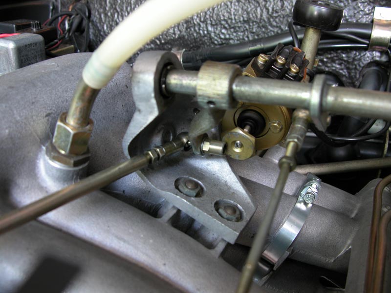

there seems to be an aluminum plate that sits between the intake manifold and the exhaust manifold. I cant really see the bolts that attach everything to the block.
The aluminum plate is held on with two clamps. See picture below which shows one of the clamps:
You can use a screw driver or the proper size socket to remove the clamps.
You might need some penetrate on the screw threads to get them lubricated prior to removal.
