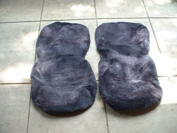

I have a couple of lamb sheepskins for sale.
They are dark blue, and seem to come from Germany.
The first owner of my 1971 280 SL bought them to cover the seats. He also had brand new original seat covers in Germany that he gave me when I bought the car 6 years ago. I had the new covers put on the car and I took of the sheepskins, cleaned them ans stored them.
Now I have to move and  will consider selling them.
They seem to be in good shape, apart from a small tear on a side, which could be easyly fixed and is not noticeable.
See picture

jmbour,
Thank you for the offer and the picture, but the blue would look very out of place in my car.  Perhaps an ad in our For Sale forum would produce a sale for you.
