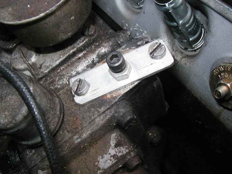

Hello Jim - - The WRD on my FI pump was damaged beyond repair by corrosion. As you have found out is very difficult to obtain these units by themselves. Out of desperation I came up with a temporary fix that is on the way to  becoming  my permanent fix.
I ELIMINATED IT !  Here in California I am able to get away with this "cheap trick" because we have very mild winters. It is nothing more than a jack screw with a locknut to hold the correct warm running pump setting. For what it is worth - - Larry in CA
Download Attachment: WRD-over-ride-device.jpg

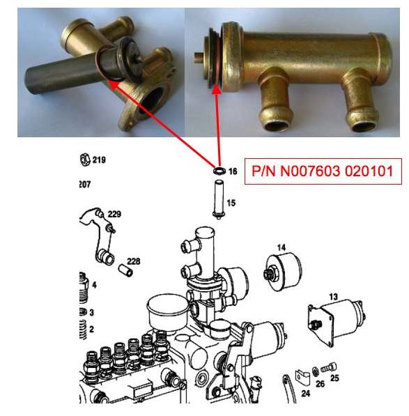

following your description I tested the thermostat and I am happy that the pin moves by 3 mm as you described. However, I noticed that there was no O-ring to seal in the thermostat. Did your WRD have one? Also at the base of the thermostat there was glue-like material, could that be an old seal ring? I am attaching a picture which I hope will show what I mean.
On the SLS web site it shows the 230 SL thermostat parts but it is not clear to me whether this O-ring goes beween the housing (the one through which water circulates) and the thermostat base or between the stem and the lower valve body. Does anybody else know?

I believe no 'O' ring is used to seal. I used some ptfe tape around the thermostat base.
Item # 69 on the SLS picture is a copper ring - I believe its there to adjust to air flow during warm-up. I remember playing with it to get a decent idle speed from a cold start.

I had forgotten that I had ordered this copper O-ring (part number: N007603 020101) from the local Mercedes dealer and when it finally arrived I wanted to find out where it goes.
Both  Hans at H&R and Gus at Pacific Fuel Injection assured me that it goes between the coolant housing and the base of the thermostat as shown in the picture. But only the older style thermostat requires the ring, the later shorter version does not.
In addition to the copper crush ring they also use some Permatex for sealing.
