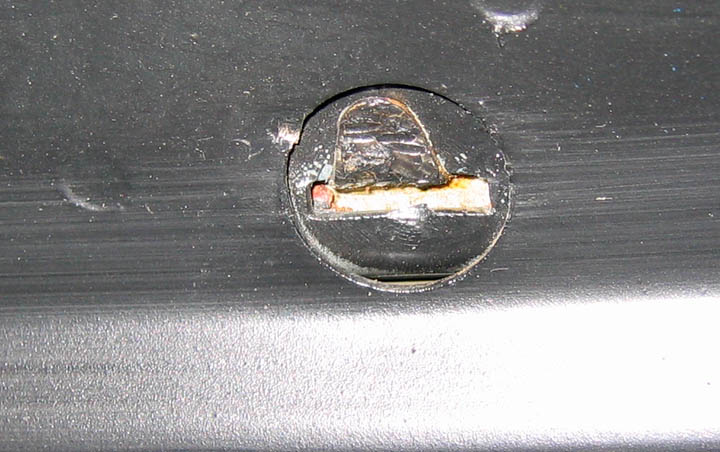

Mike are the "twist" attachments same as those in this photo"  Mine seem to be tabs (see photo) Are hese the same thing?

I used a local shop, GAHH to do my leather.  They had no problem with the top lid insert.  I supplied the repainted top, metal reinforcement piece, and chrome trim.   They assembled the whole works and it looks like new.  Just bend the tabs perpendicular to the lid, and the old leather will peel back.  The small chrome strips fit over about 12 small clips.  Just pry them loose and pull off the clips with pliers.  Good luck.

Yes, those retainers in your picture are same as my car except they are not bent over, they are twisted about 1/8 turn. I did a spot check on 2 other SL's nearby, both were twisted. While bending might work fine, it seems to me that twisting ensures a tighter fit than bending. Either way, be careful not to tear any of these tabs. Your milage may vary.
