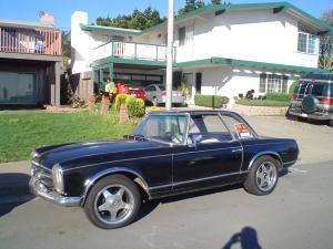

I am 26 years old, currently looking to buy my first SL.
I found a nice looking 1965 230 SL but I am wondering about a few things:
1.  The VIN # is: 11304212008320.  Does this mean anything to any of the seasoned vets out there?
2.  Owner says vehicle was imported from Germany.  It's a "three seater" with a little back seat facing sideways in the back.  Owner claims only 300 of these were made.  Is this true?
2.  Has only 69,000 original miles and all paperwork looks OK.  Missing rear bumper and original tires. Still haven't had it in to a mechanic for inspection. Owner is asking $8,500.  Any advice would be VASTLY appreciated.
I attatched some pics.
thanks,
Soren.

The Vin would be for a 230 SL made in December 1964 (likely called a "1965"), the middle number "12" shows it is a Left Hand Drive with automatic transmission.
"Imported from Germany": since all Pagodas were imported from Germany maybe the owner means this car was originally made for a German customer and was later sent to the US. If this is true, the car is a "Euro" model rather than a "US" model. The Euro typically has different headlights, has instruments in KM instead of miles, might have a slightly different spec for the engine and rear end ratio.
The photos show Euro headlights so maybe it was later exported later  to the US. The photos also show that the wheel covers are not original. Fog lights are a little unusual for these cars.
The number of sideway back seats is not known to me. I have never seen a count of this option. It is not a common option. Some of these seats were dealer installed and I think it would be difficult to make an accurate estimate. Wonder where he got the number 300 from?
Eventually, you can get the Data Card for the car which will tell you what options the car came with but for now a mechanical and rust inspection would be very wise.
I think this site has an article about what to look for in a purchase. Use the Search button to find that article.
$8,500 is reasonable for a 230 SL in fair condition.
Others will chime in here with more info.
