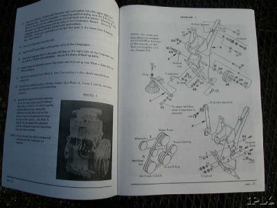

I also have the new style bracket and pully setup i put them in a box and switche over the style provided by bud's benz the one uses the new style rotory compressor that requires alot less horsepower and was a little les truble to install.
attached is a picture of what the arangement for your type of bracket should look like.
Download Attachment: i-3.jpeg

Re: A/C belt Discussion (again)
« Reply #4 on: April 12, 2004, 11:48:28 »
Jerry-Thanks. Understand. Do you have the correct part numbers for the water pump and pulley I would neeed to do the setup you included as an attachment. Also what does the Bud's compressor bracket and setup look like ? I'm waiting for "230SL67" to come back witha reply--he said he has a dealer installed system that someohow gets this all right.

« Reply #8 on: April 16, 2004, 19:36:07 »
Thanks to all for the replies on this. Have reached a number of conclusions after wading through all this. The setups with the earlier cars are definitely different from those on the 280Sl, primarily because of the water pump/fan arrangement and the number of slots on the crank pulley. I believe work arounds can be figured out to make the newer style compressor bracket work on the older cars and I'm going to give that a try. Based on the picture Jerry Pyles sent to me, what I think will work to get around the problem of the single water pump/fan pulley on the older 230's is to locate an idler pulley on a short bracket extension off to the right hand side (just to the left of the distributor). With an idler pulley thus located, I should be able to route a belt around the second crank slot, around the idler and then around the high mounted alternator. Jerry's new style Bud's bracket gave me the idea of the idler and looking at a number of other MB applications, this was a quite common way of routing the belt around the fan assembly. When it is all together I will provide a picture. As a backup, I've contacted Bud's Benz and they will sell just the A/C bracket for thier version of the setup.
