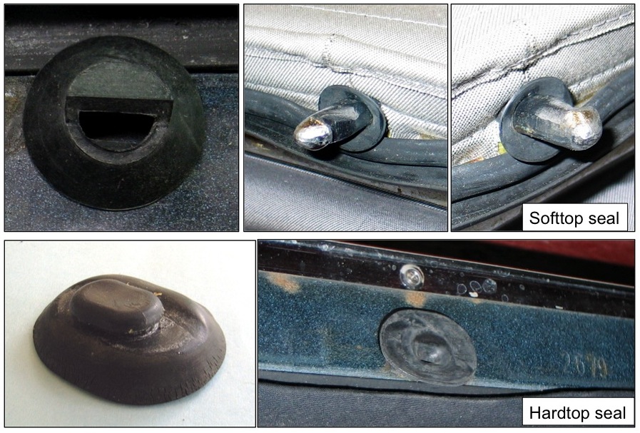

Also don't forget to close the hole in the bottom of the hard top as shown in this photo:
http://www.sl113.org/wiki/uploads/Tops/Escutcheon_seal.jpg
