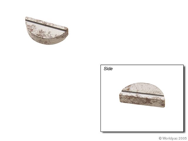

Camshaft Woodruff Key
An offset to the right(in the direction of rotation) results in an earlier valve opening, while an offset to the left results in a later valve opening.
5 Degrees:  1.3mm = 10 deg. at crank
4 Degrees: 1.1mm = 8 deg. at crank
3 Degrees: 0.9mm = 6.5deg. at crank
2 Degrees: 0.7mm = 4 deg. at crank
if needed one can also remove a link and add a key to correct timing
Download Attachment: offset.jpg
14.14 KB

here are the current part numbers for the offset keys
621 991 04 67  2 deg at cam 4 at crank
621 991 02 67  3 deg at cam 6.5 at crank
621 991 01 67  4 deg at cam 8 at crank
621 991 00 67  5 deg at cam 10 at crank

The valve timing can only be set with a dial gage and a degree wheel on the cam shaft.
 The correct setting for checking valve to piston clearance is 5 degrees ATDC on number 1 piston. You need to use a dial gauge and push down on the intake valve until it hits the piston. You need about 1 mm of clearance.
The piston actually slows down and stops when it reaches either end of it's travel as the crank goes over center. Since the piston stops but the cam shaft keeps moving the valve will get very close to the piston at 5 degrees ATDC until it starts to move down in the cylinder.
The off set key moves the cam shaft and not the gear so the guy at Metrics is being straight with you about that. If there is no off set key and the marks are out slightly it's not the end of the world. Unless you do the valve timing test according to the BBB it's all suposition anyway.

The woodruff key carries no lateral tourque and so it should never break off. When you tighten the screw it presses the gear against the cam shaft and prevents it from turning. The woodruff key is there to set the relationship between the cam gear and the cam shaft with the intent of  keeping the cam shaft and crank shaft in time with each other . The woodruff keys on the distributor drive and on the crank shaft act in a similar fashion.
Only the cam shaft is provided with an off set key to make adjustments for machining and other variations. The trick is to always use a new crank shaft gear if you have the bottom end apart. The crank gear has to run the cam shaft, oil pump, distributor, injection pump and idler gears. It takes a pounding and wears out twice as fast as the cam gear. If the teeth on the cam gear are pointed you can bet the crank gear is badly worn. Best bet is to replace all the gears during rebuild.
