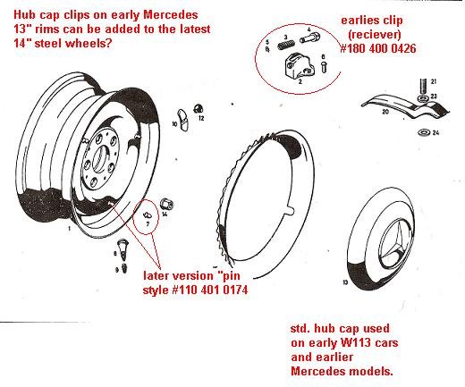

Here is more info Michael,
Download Attachment: wheel clips.JPG
44.66 KB
The 190SL site shows a nice photo of the early clip retrofitted on late 14" rims.  http://www.190slgroup.com/tech/pics/det_34.jpg
44.66 KB
Joe,
I was under the apparently mistaken impression that your post originally stated the receivers were needed for the one piece wheel covers, not the early-style 2-piece.
Yes I see what they are now, but since I own a '69 and it has always had the later style wheel covers, these receivers were not and are not necessary--not on the OEM steel wheels W108 of this vintage nor on the rare and elusive aluminum replacements ex-W123--of which I have both sets.
Sorry for the confusion.

« Reply #5 on: January 08, 2008, 19:15:21 »
Hello Michael,
No problem. Your original 69 wheels should be the 108 400 00 02 version which has a stamped "reciever" in the wheel, unlike the two shown previous.  These wheels will accept the full wheel covers and the early hub caps as is with nothing added or attached!
