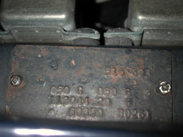

« Reply #1 on: December 22, 2003, 10:44:31 »
Tim,
There is a plate in the engine bay on the left side of the car near the relays. See picture. In this case the 050 G / 050 G is the paint code for car/hard top. I believe 050 is white but the car has been repainted blue!
Download Attachment: 280plate.JPG
39.71 KB
'Kloines Scheisserle'
« Last Edit: December 22, 2003, 10:48:25 by naj »

Re: Original paint Colour
« Reply #3 on: December 24, 2003, 21:51:02 »
Tim,
Did NAJ answer your question?
James,
I assume your plate is on the door jamb instead of the fender, not in addition to the fender?  Can you supply a photo of your plate?
« Last Edit: December 24, 2003, 21:54:12 by rwmastel »
« Reply #6 on: December 30, 2003, 12:19:05 »
Hello Tim, Rodd & James,
ivory and black with red-vinyl interor was a very common color scheme in the sixties. It is absolutely usual for a 230 or 280 SL.
Personally, I do not like ivory 670 (Hellelfenbein) so much because it is similar to ivory 623 (Hellelfenbein) which all German taxis must have ... But that is the only reason and my tast is not important here. Furthermore, an SL does not look bad in ivory ...
Rodd, James,
early 230ies had their body & paintcode number plate in the door jamb (A pillar) instead of the relay holder bracket in the engine bay. This scenario is identical to what 190 SLs (and other pontons) have.
The body numbers do look very very similar to the VINs and do only have one digit less.  :)  ;)  James, if you "really" have a very early 230  ;)  then the "serial part" of this body number is identical to the serial number within the VIN. But I know for sure that this was not more the case with VIN 000218 which has body number 000219  :D  :D .
I do not exactly know when this changed to the typical paint code plate, I think it was in very early 1964.
All the best,
(Magdeburg, Germany)
