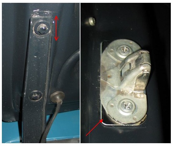

Most likely your solved your problem by now but if not maybe this will help.
After I replaced my rubber gasket recently suddenly the same problem that you described appeared and I could not figure out why.
Fortunately I had not done a good job gluing the strip into the groove below the lock and it came loose. When I pushed it back in (to be reglued later) I noticed that the lid would now close easily. Turns out that I had originally oriented the strip in such a way that a lot of the upper lip was showing which apparently caused my problem. With the lip barely sticking out under the lock it closes much better (lower panel in picture).
