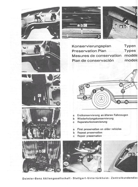

We got our Pagoda nut and bolt restored last autumn and found a fair amount of structural rust under a seemingly nice surface. Needless to say we wish this not to happen again and living 200 m from the coast line in a country with a very aggressive humid coastal climate, we know how important decent rust proofing is to keep the dreaded corrosion away.
Modern vehicles are taken to special rust proofing work shops using commercial products such as Tectyl and Dinitrol etc. and most important, the workshops have so-called 'spray-schedules' which in details shows the cavities to spray with thin penetrating oil/wax and where to spray with a thick wear-resistant layer.
What we learned from our restoration is that most corrosion comes from inside and out. Condensation builds up in cavities, sub frames and sills and eat the metal slowly but surely if not rust proofed.
I don't know of any who has a 'spray-schedule' for a Pagoda and it was probably not invented when these cars were in daily use. However, I would be extremely grateful if any of you would share your experience and knowledge concerning roost proofing your treasured Pagoda.

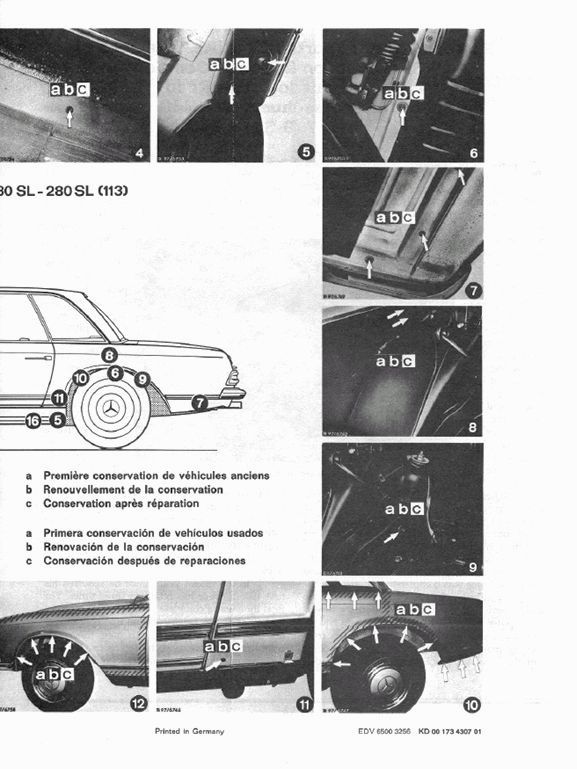

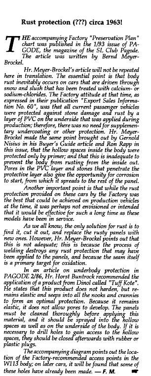

Here are the three page article and pictures for rust protection - courtesy of Tom - Mercedes club old magz.
Abbas

The attachment posted by Abbas (for which many thanks) looks great, but can I ask for some clarification? Does the diagram show the areas where one should spray in something like Waxoyl? Also, what is the aim (other than to prevent rust) - I mean, is the aim to spray the inside of all panels with waxoyl and thus prevent water doing damage that way? Also, what preparation is required before goo is sprayed in? Clearly it's not possible to clean these areas without having the car in bits.
Can you provide a little more info?

Tom,Abbas
Thanks a million, exactly what is needed! Hopefully many members will do the rather messy, but rewarding job to preserve our Pagodas.
