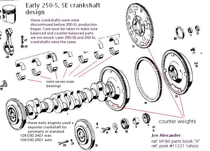

The counter balanced flywheel and crankshaft was used in the earliest sedan 250 SE engines only up to engine #004789 with automatics. This can also be confirmed by the different counter balanced crankshaft #108 030 2501 instead of the #108 030 4301 (balanced). The flywheel from these early engines will not work with your crankshaft. Any of the later 250 SE flywheels will work fine.

There are several possibilities here. One may be that the previous owner put the correct counter balanced flywheel on when doing the swap. Another is he used the balanced flywheel on the counter balanced crankshaft which would leave your engine with an imbalance and unusual vibration, especially at higher rpms?
I have parts catalog "A" and "B" on the 250-S and 250-SE. The early version in catalog "A" shows the counterbalanced set-up and verifies it with part numbers. (click on the enlarge button to improve these images)
Download Attachment: early crank design.jpg
79.56 KB
The later catalog "B" shows the later design with balanced crankshaft and flywheel. (I am currently trying to add this catalog "B" page also but am having trouble compressing it to fit, will keep trying.)
Be aware that the early version 250-S and SE engines with the counterbalanced arragement was changed before production began on the 250-SL. So this counter balanced arrangement was never used in the W113 SL. However if anyone is using early 250-S or SE engines or parts in a W113 they could possibly have a problem.
I have rebuilt several of these early counter balanced engines. They are not common but they do exist. You should also review Pete Lesler's post #11221 on the old Yahoo W113 site for some additional information.
One additional way to check to see if your 250-SE engine is a counter balanced unit is to look at the front crankshaft dampner from below. If it is a counter balanced unit it will have a single large mass. If balanced it will have  three smaller masses spaced equally around it. Thanks for the input. Hope this helps clear-up some questions.
