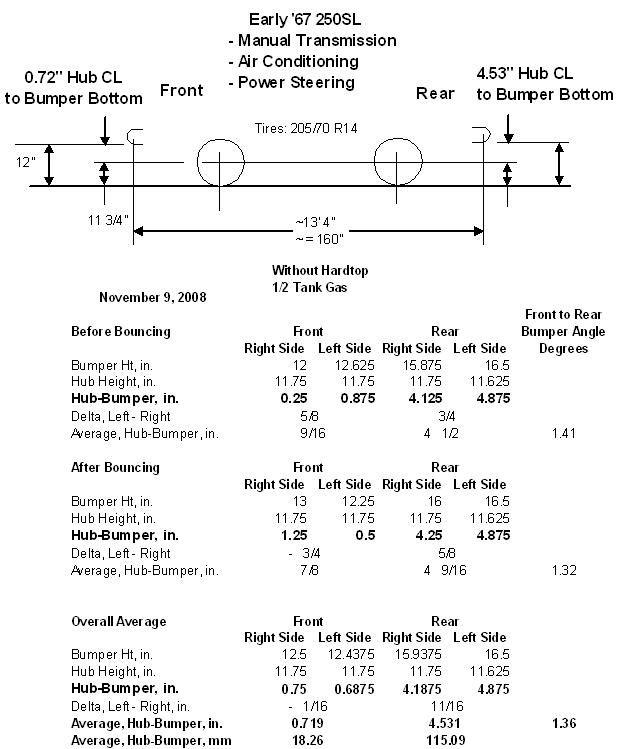

I don't understand your height measure of 25 +/- inches... from where to where are you measuring?
Regarding my experience with Olson's progressive springs, I have none.  I cannot purchase springs without knowing their stiffeness's and if progressive springs, their multiple stiffness as function of displacement or load.... I'm not one that's inclined to trust anybody that cannot supply the functional measures required to assess the characteristics they're marketing.
For your reference, I've measured my 250SL's ride height, with 1/2 tank of gas in it and without the hard-top on it.  The measurement of interest is from CL of Wheel Hub to some part on the body... in this case I've used the underside of the front and rear bumpers at right and left sides.  I don't think using the bumpers is a reliable body part to measure since these can be adjusted, but they were immediately convenient this evening.  A better measure on the body perhaps might be the outside edges of the wheel wells directly above the hub CL's on front and rear fenders, or some other non-adjustable feature on the body.  The distance of interest to the body must be from CL of hub, since this removes all influences and differences associated with tire/wheel sizes, how well inflated they are, etc.
In my case, the front measurements could possibly increase slightly as the rear would drop when the hard-top and full tank of gas is in the car.... since the rear would drop more the angle of the car would change ... therefore the horizontal distance of the front bumper from the wheel hub (therefore front spring) is also extending the "drop" from wheel hub.
I also note a right-left difference in my ride heights.... with right side lower than left in the rear... I assume this is because the spare tire is on the right side.  Also, please note that the measures are dependant on whether or not you bounce the car Up or Down.  The proper procedure is to make two measures each after pushing front (and rear) bumper up first, then letting it settle by itself, and then pushing front (and rear) bumpers down first, then letting it settle.  The average of pushing it up and down (and after settling) is the actual most correct measure.  These "up" vs "down" pushing procedures will differ and can be significant especially on the front measures.  In my case the difference was at least an inch on the front measures.

You're seeking ~13 inches ride height citing measurement from hub CL (center of star on hubcap) to bumper lip of fender opening.
"I find the best way to measure ride height is to measure from the center of the star in the wheel cover, vertically to the bottom lip of the fender.  This way your measurement isn't significantly affected by tire pressure or size."  I agree with your method, though I haven't measured  (recorded measurement) mine at that point yet.
My measures (hub CL to bumper undersides) are ~0.75" & 4.5" (front & rear respectively, without hard-top & 1/2 tank of gas).... see my prior post and the attachement to it.
I'm attaching a random photo from one of the forum's pictures of W113's that I've drawn some lines on and scaled to a tire radius of 12" (center to top of tire to eliminate any inflation effects) just for an approximate measure of a random W113's front and rear ride height as measured from Hub CL to underside of bumper.
The random scaled W113 pic shows approximately 1.8" & 4.15" ride heights (front and rear respectively) as measured by your description (and my measures on my car the other evening).  These measures are approximately the same ball-park as I measured on my car.
Scaling to the fender lip the ride height is approx. 13.4" & 12.9" (front and rear respectively), so in reasonable agreement with your targets --- reasonable because scaling on the photo is not that accurate (I blew up the picture to 400% of normal to scale it).  If I account for the lack of the hard-top, the rear would drop by 0.15" with standard 250SL/280SL springs, so the scaled values would change to 13.4" and 12.75" measured from Hub CL to lip on fenders.
Ride Height with the hard top on will drop the rear no more than ~0.1" - 0.15" wrt ground , so the scaled pic and my car's ride height at rear would drop to ~4" & 4.4" respectively from hub CL to underside of bumper.  Allowing 11.75" from HubCL to ground (owing to tire's 'flattening effect' under load) would put the random pic car at approx. 16" from underside of bumper at rear to ground. If I add my hardtop and another 8 or 9 gal's gas to my 1/2 full tank would drop my car's rear end another ~0.3" putting it at an estimated 4.2" - 4.1" from Hub CL to underside of bumper, or 16" from ground to underside of bumper.
In otherwords both my car and that of a random sample scaled picture show front bumper underside at approx. 1" - 2" above Hub CL and rear bumper at about 4" - 4.2" above Hub CL.  .. or ~13.25" &  ~15.85" from ground (front and rear bumper undersides respectively).  ... with hard-top and full tank of gas.
