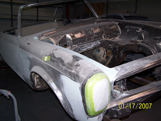

Bob is your body shop using a lead or plastic filler?
« Last Edit: January 16, 2008, 21:19:09 by hauser »
Re: Euro Headlights
« Reply #26 on: January 17, 2008, 18:18:05 »
Hi Guys,
My shop is not using lead, rather a modern filler.  Any body experts out there that can comment on the pros and cons of lead vs modern materials?

Is that a brand new firewall??

Hi Rodd,
No, the original.  They stripped it using a soda blaster.
Nice and shinny :) !

Bob followup
How did the paint shop make out on getting the fender and headlight chrome to matchup?  Did they work the fender to match the ring or the other way around?  Did they also do a good job with the inner fender notch?

Hi Bruce,
They spent many hours working in and ensuring the notches were there.  Also a lot of time making the headlight buckets/fenders line up with the headlight chrome trim rings...  We had to "sacrifice" one of the rings to sanding damage to ensure proper fit and finish :( ...  After going through this, it is easy to see why the factory may have used headlight molds to sand around....
The body shop is still working on the paint and I "hope" to get it back soon so that I can start to put it back together again.

Well done lead would be the best way to go but people who still know how to properly do lead work are few and far between.
For my money I don't think there is anything wrong with modern plastic fillers. With all the low buck slap it together body shops in the world when was the last time you saw a car with a crack in the filler or a chunk that has fallen out?
Re: Euro Headlights
« Reply #32 on: April 23, 2008, 07:49:25 »
From what I understand, poorly done lead filler (read: insufficient cleanliness beforehand) will eventually lead to bubbling through the paint.  In the absence of the shop's clear experience with lead, I would not volunteer my car as their lead-filler practice run.
A beautifully finished paint surface usually does not invite questions about type of filler used.
