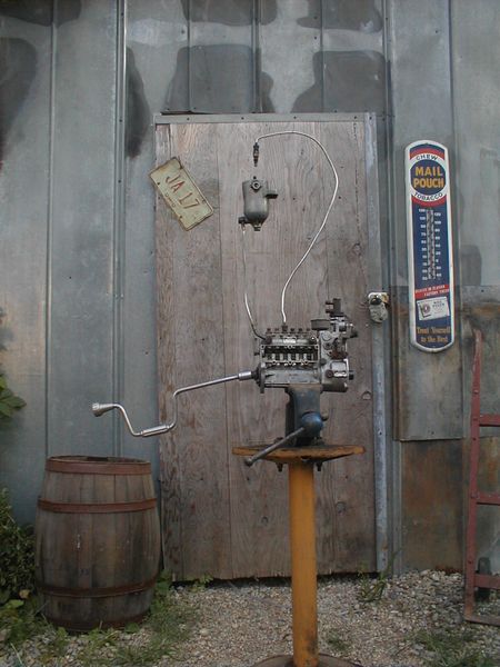

Should I take the side cover off the IP and turn the engine to check if the pistons are free. Or just wait until I get it started and see what's needed then? (I read about stuck pistons on some other posts.) Will I need a new side cover gasket, and where would I get such a thing if I do? It seems easy to play with the IP now, but scary for me to open it. It looks like it'll be difficult to address if in the car.
You can do the "Blacklick Test" on the Inj Pump
