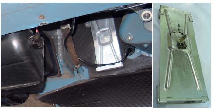

Yes it does.  There is a square hole in the firewall (next to the infamous drainage tube) that accepts a clip nut to hold a bracket for the audio amplifier and the voltage regulation circuit. A Europa will be dead silent without it. [:0]

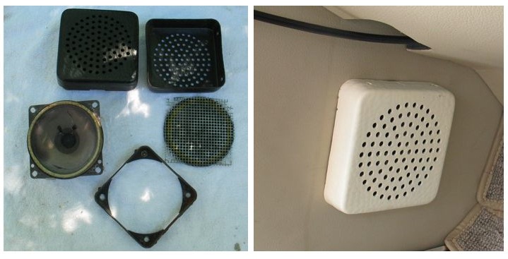

yes I did, but only the speaker frame and cover, NOT the speakers. I bought a pair of broken Becker speakers and a new pair of Alpine 4" 2-way (concentric dual cones) speakers and matched them up. Also changed the color on the old speaker covers.

..and mounted them further forward/higher than they would be in a 280 by the looks? does that mean you were able to avoid cutting new holes? How do you like the sound? Thanks for your clear and illuminating photos btw!

No I had to cut - but only on the left (driver) side since there is no opening in the metal panel.

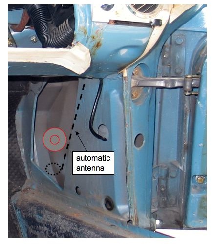

I have an automatic antenna which limited where I could place the speaker.  After I cut the hole for it in the cardboard panel and checked that it worked I placed the right board over the left and cut a hole in the same position. Then I used that board and marked the metal panel where it needed to be cut, so the positions of the speakers is a mirror image.

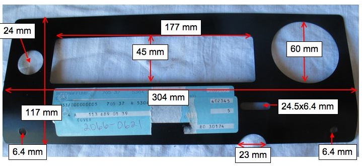

A member of the German group (Pagodentreff.de) makes a repro and sometimes sells them on eBay under the name "Pagodendoktor". Contact him through eBay and check whether he has more.
But if you want to have one made for you, here are the dimensions:

the standard DIN opening is 180 mm x 55 mm.  You could put a Europa II Stereo in, or even a Mexico Stereo with station seek and Cassette, if you wanted.
