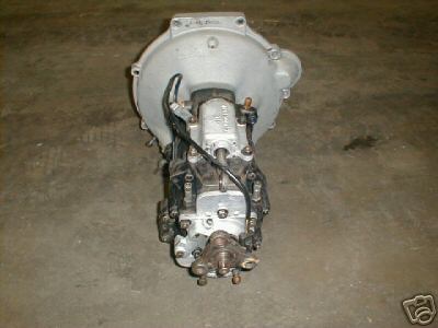

Can anyone tell me from the attached photo if this is a ZF S5-20 gear box.  I do not have a part number and this is the only photo i have

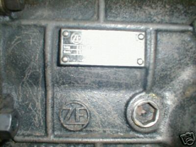

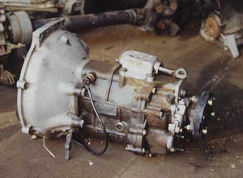

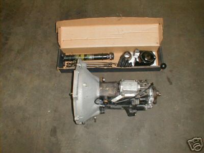

[updated post due to correction by Hans and Dan above]
My only reference for the S5-20 gearbox  is this set of pictures (not my pictures):
Download Attachment: zf-top.JPG
17.69 KB
Download Attachment: zf-rear.JPG
18.39 KB
Download Attachment: zf-closeup.JPG
23.91 KB
Waqas in Austin, Texas
Yes Garry, it looks indeed as if the photo depicts a ZF S5-20 box, suitable for mounting in a Mercedes
