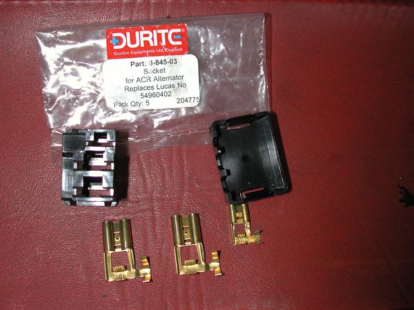

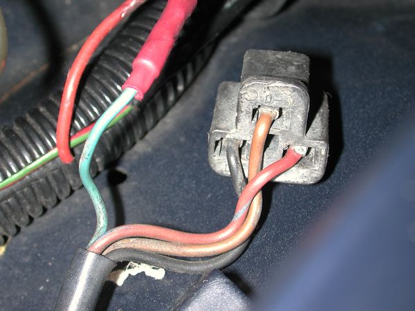

If you use the Alternator with internal regulator, the two bigger wires from the B+ terminal connect to the two big spade terminals and the patch from the blue wire at the regulator connects to the smaller spade terminal in the plug.
Alternator Plug
« Last Edit: May 18, 2008, 07:49:38 by naj »
