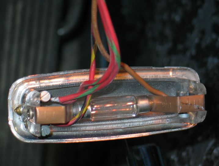

because I bought the car in boxes I have alot of wires I am trying to figure out where they go, I have the wiring diagrams but can't seem to figure out colors.  I have a bundle of wires that start behind the tach and come to the radio opening together there are 4 wires They are colored: (#1) all brown  (#2) red and black with a yellow stripe (#3&4) red and green.

these could be the wires for the cabin light:

THAT IS IT!!!!!!!!
Thanks!!!!!
