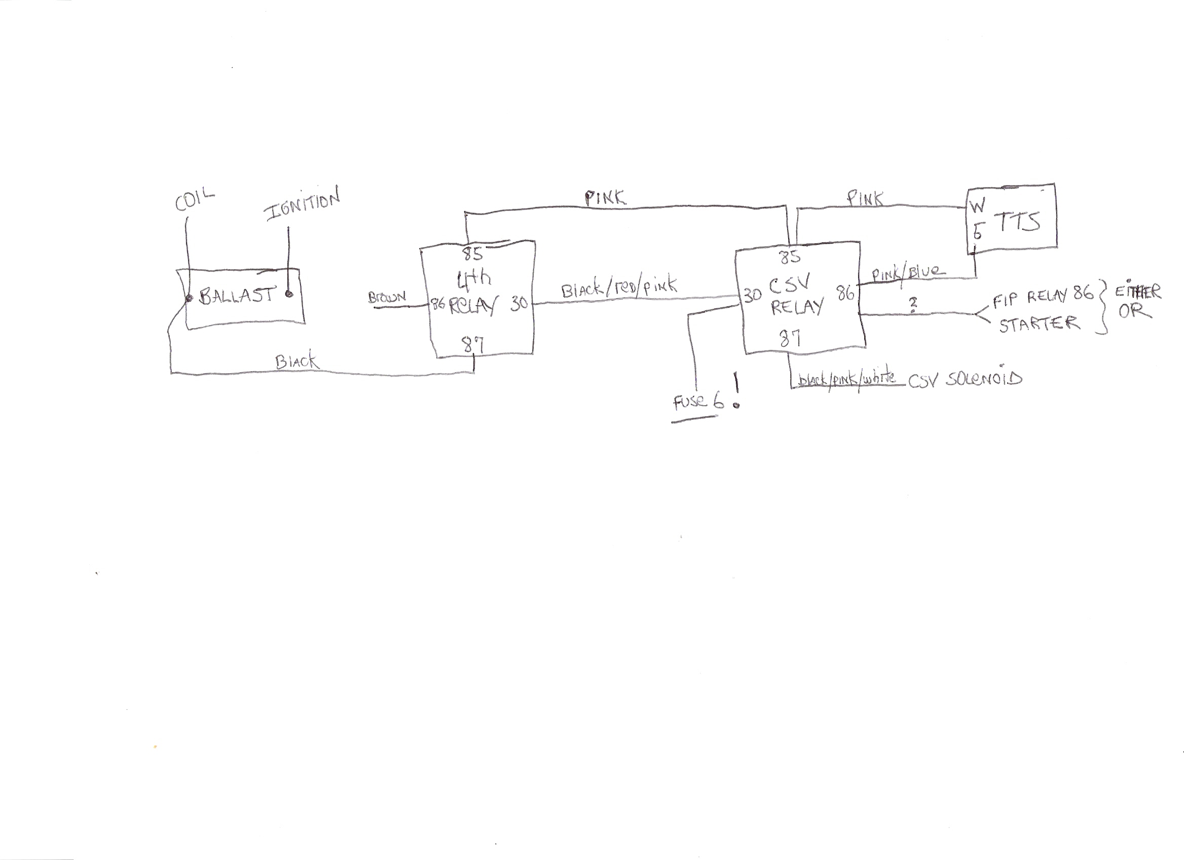

Here is a drawing of the wiring, as best as I can tell. Please note that pin 86 of my CSV relay only has 2 wires, whereas the published schematic shows three. Because I cannot make out the colors too well, I am uncertain if one of these 2 wires goes to FIP relay 86 or to the starter/ignition.
Pin 30 of both the CSV and 4th relay go to fuse 6, which I guess would explain why the fuel pump activates when power is applied to 87 of the 4th relay.
I cannot make sense of the function of the 4th relay from this setup!

Re: Unidentified 4th Relay-'69 sl
« Reply #10 on: June 09, 2008, 19:26:31 »
Andy,
Your sketch indicates the 4th relay is being used to bypass the the ballast resistor.
I assume the brown wire of this relay is a ground.  Can you check this to be sure?
I need to understand the operation of the TTS a little better.  I think when the engine is cold terminal W on the TTS is grounded. I know pin G is fed from the ignition during cranking. As the TTS warms up does power pass from pin G to pin W?
If you put the 4th relay out of the picture for now you can see that while you crank a cold engine, ground is provided to pin 85 of the CSV relay(from the TTS) and power from the start position of the key is provided to pin 86.  This causes the relay to close and power is sent via pin 30 to pin 87 and on to the CSV solenoid and a mist of gas is injected into the intake manifold.  As the TTS warms up ( 12 seconds or so) the ground is removed from pin W of the TTS and the CSV will not operate.  This completes the operation of the CSV relay.
The fourth relay- If the brown wire is a ground and the TTS/engine is cold nothing will happen with this relay.  The way your car is wired the ballast resistor will be bypassed only after the TTS is warm and power passes from pin G to W.  When this occurs power from pin 30 will be connected to pin 87 and +12V is sent to the coil to make a hot spark.  This only happens when the TTS is warm.  As mentioned earlier when the TTS is cold nothing happens with the 4th relay and the ballast resistor is not bypassed.
My questions:
When cold does pin W of the TTS see ground. When warm does pin W see power from pin G?
As I look at other wiring diagrams it looks to me like the wiring on the 4th relay is a a mixture of concepts.  I look at the relay and part of it looks like the time circuit for operating the CSV when starting a warm engine. Then I see it is connected to the coil which is the ballast bypass function.  Maybe someone just really got confused with this one.
What about the 3rd relay?  Not the wiper relay.

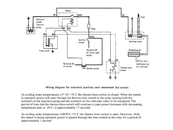

« Reply #15 on: June 10, 2008, 11:14:18 »
Andy and Al,
I think this diagram and writeup explains how the time switch should be wired.  Comments?
Download Attachment: andyrelay1.jpg
39.52 KB

I just got the June, 2008 Pagoda Notes, with Joe's tour of the starting aids (an excellent article BTW).
According to Joe's charts the version III wiring in Jeff's diagram would be for a late 230sl with the enrichment solenoid and the cold start injector wired in parallel.
A 1969 280SL (version IV) would have the injection pump enrichment solenoid activated any time the starter is engaged (possibly the original function of the mystery 4th relay) and the cold start injector operated by the thermo time switch and the one second timer via another relay.
So everything in Jeff's diagram would be correct for the version IV cold start injector but terminal 87 would not "T" off to the pump enrichment solenoid.
A USA model 1969 injection pump should have both an enrichment and shut off solenoid. Make sure when you re-route the 87 lead from the 4th relay you connect it to the start enrichment (upper) solenoid.
Several times I have had cars towed in to my shop from another shop with the start enrichment wire connected to the shut off solenoid after a new motor or injection pump had been installed.
I am currently not using the type III wiring on my 66 230sl cold start. Explaining why would only make this post even more confusing, but I too have 4 relays on the safety latch bracket. But not wired like any of the 5 standard versions, because of a starting problem peculiar to my vehicle.

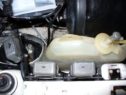

« Reply #20 on: June 13, 2008, 20:55:25 »
Maybe this picture will help.
A 4th relay in this part of the engine bay is found during a production interval of the 1969 280sl. It is wired to one of the other relays by means of a connector that is piggybacked onto the other relay's connector. The sequence of the relays may vary from car to car. The wiper, FIP, and CSV relays have been thoroughly discussed on the forum. But a 4th relay of this shape, in this location, using a piggyback connection has not been decribed, to my knowlege.
I am trying to find out the intended function of this relay.
