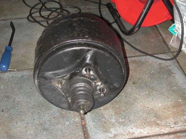

Yes, Waqas,
The LHD servos have a yoke at the end of the operating rod. RHD's just have a ball end.
Dont know if there is enough length on the LHD rod to allow cutting off the yoke and grind the rod suitably.
Picture of RHD servo:
« Last Edit: June 11, 2008, 13:42:31 by naj »
