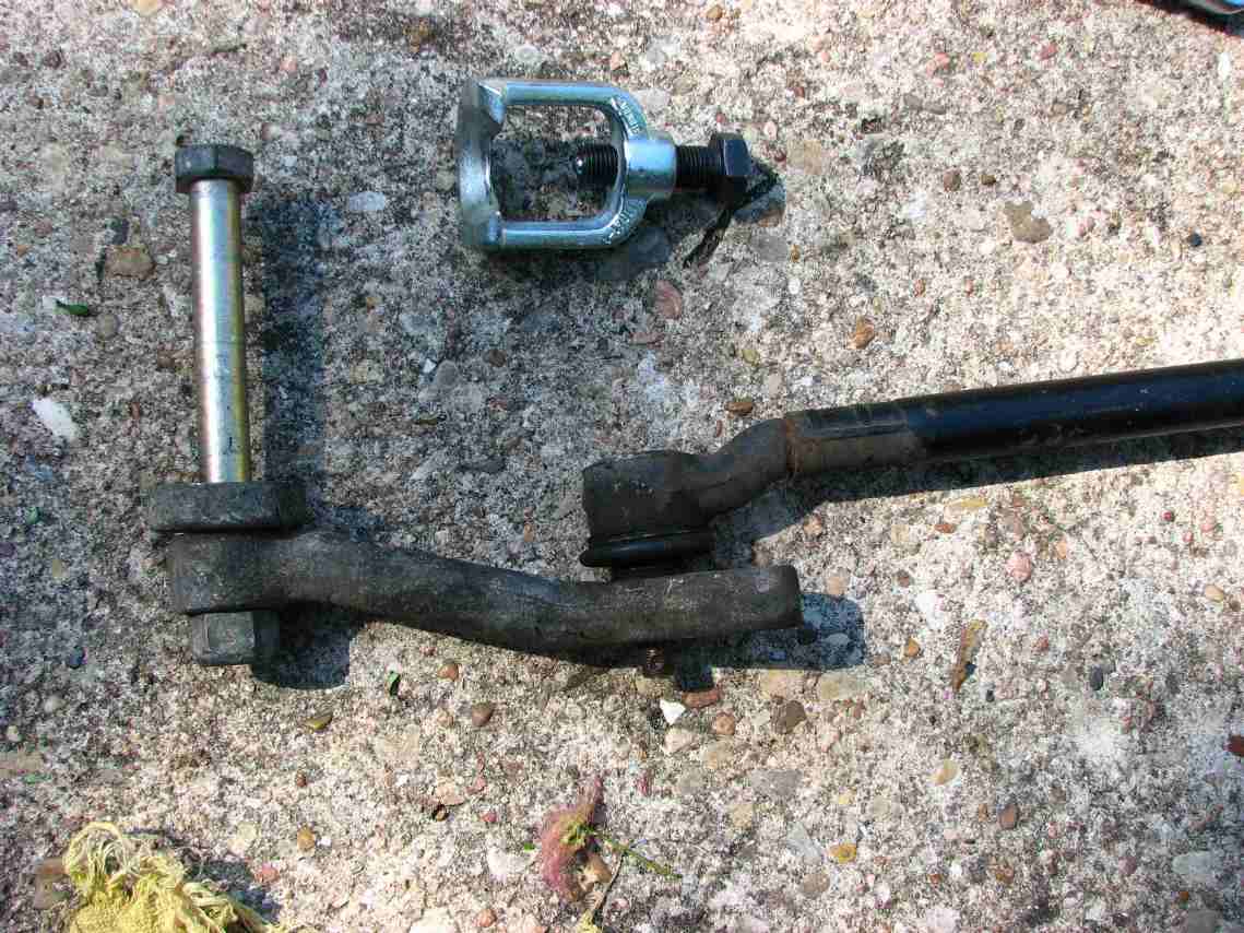

    Now that I have my puller in hand, I thought I'd try it out on some steering pieces lying around waiting to be dismantled (from an old 108).  I was amazed at how much easier this was!  (when you have a puller of the correct size, as opposed to adjustable-jaw pullers and pitch-forks)
    Download Attachment: IMG_4816-smaller.jpg
    47.82 KB
    In fact, Hans is correct in that it can be used on all ball-joints, including the drag-link.
    However, the tie-rod end must first be removed:

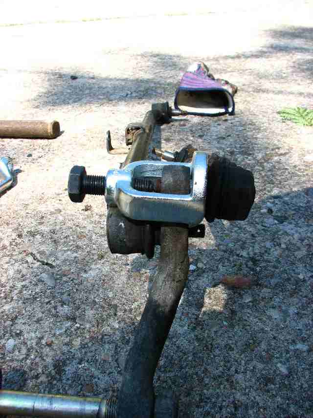

    Download Attachment: IMG_4817-smaller.jpg
    114.5 KB
    Then, the puller direction is reversed and slid further along either the idler arm of the steering arm to pull the drag-link:
    Download Attachment: IMG_4819-smaller.jpg
    97.59 KB
    I have to say this is the most worth-while investment I've made in a tool of late. Thanks again for all the input.
