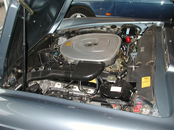

Here's an MB 5 litre aluminum block engine in a 230 shell.
I was told this engine is lighter than the original I6 cast iron block engine.

Is it a 5.0 litre V8 as mounted on a w107 450SL 5.0?
Looks good anyway...I'd love one too!

« Reply #10 on: September 11, 2008, 02:47:54 »
I believe it was from a W126 500SE
