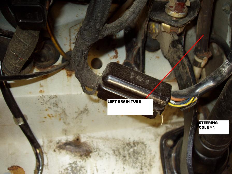

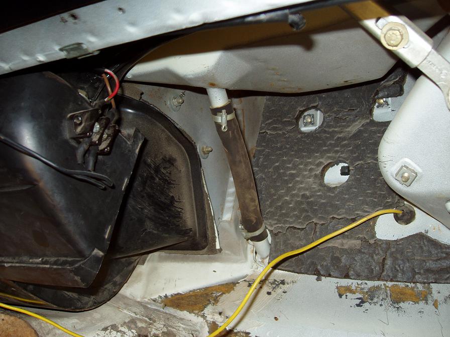

The drain tubes from the fresh air box are up under the dash.  You have to remove the underdash panels to see them.  Here are some pictures.
Right Side
Left Side
Pete S.

I agree with everything that's been said and I'll add a few things:
1. Your worst enemy is the fact that the car is a convertible and past a certain age you'll get leakage into the passenger compartment that stays in the carpet and never dries. This gradually works in between the over- and undercoating on the floors, especially in the corners and hollows them out, destroying the metal but leaving the coatings intact. Thus the floor rust you can see may just be the tip of the iceberg, though from the pictures you show, I don't see a lot.
2. The drainage tubes with hoses shown in your picture look intact, and that's very good. *Keep these clear*. They easily get clogged with wet debris, and being steel, they will rust and water will ingress into the chamber forward of the dash that they pass trough and are supposed to protect. Mine did that and I had to re-fabricate that whole structure. While I was at it, I replaced the through tubes with with copper ones.
