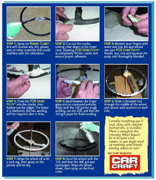

I've not used the POR 15 steering wheel repair kit but I have used some of their other products and cosider them very good.
http://www.por15.com/PRODUCTS/COMPLETEKITS/STEERINGWHEELREPAIRKIT/tabid/109/Default.aspx

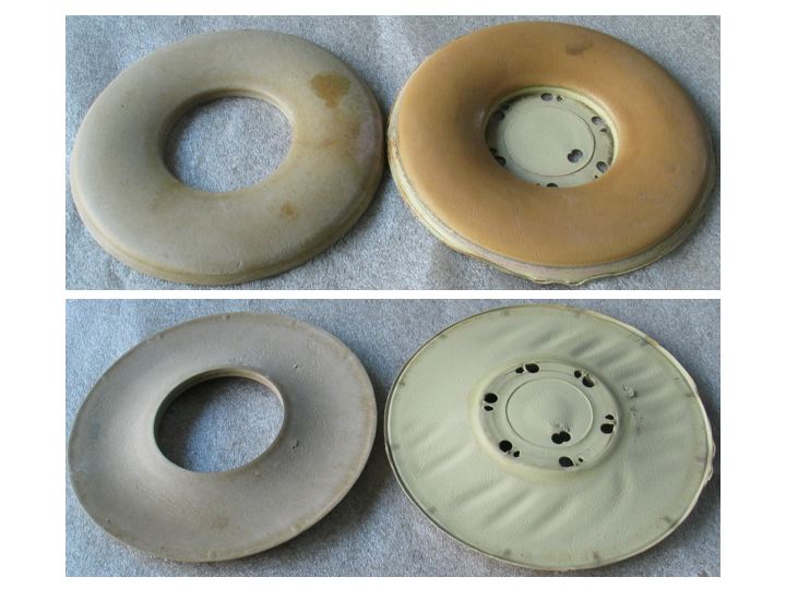

I would like to revive this topic and add another question.
Who has experience in refinishing the horn pad?
I would like to change the darkened and somewhat stained MB-Tex pad on my Type-II wheel - perhaps with leather matching  the rest of the interior or some vinyl similar to the original.
In the original pad the the foam ring was welded into the vinyl as shown on the right:
The vinyl in the center is quite thin which allows the tabs on the ring that holds the center star protrude far enough on the back side of the plastic disk that holds the foam pad so that they can be easily bent 90 degree to secure the star and the pad:

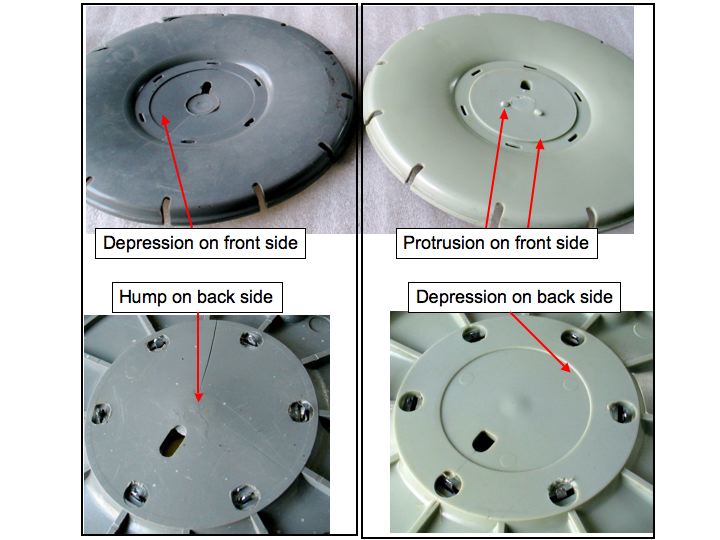

Here are the problems. My original disk (green one on the right) is cracked and I wanted to use the gray on the left. That gray one has a raised ring - recessed center on the front which makes it difficult to press the ring with the tabs in deep enough so that they can be bent on the back side.  The problem becomes worse if I try to use leather as cover since it is thicker than the original vinyl. I am not sure I can grind down the whole center part on the disk since there is not enough material.  Note that on the back side it has a depression.
I have another question for those who have tackled this refinishing problem successfully.  What is the best way to stretch and secure the new material (leather or vinyl) around the outer edge of the foam ring??
Thanks for any help that you can provide!

Eastwood also has a complete steering wheel repair kit... includes epoxy for the cracks, primer, color coat of your choice, and clear coat... I'm changing my black wheel to White.. let you know how it turns out.

Horn pad - my horn pad was chocolate in color when I got the car. I soaked it in bleach (normal bleach for clothes) overnight and the result was amazing. Of course, not back to the original color but a darker shade of ivory, which is perfect because the patina is there. My restoration philosophy is 'sympathetic restoration' so patina is very important.  The bleach did not harm the vinyl at all.
No experience in re-covering the horn pad with leather etc.

Hello Alfred,
(Don't know whether you are still interested in this topic or if you already done with your horn pad but ...)
Only the steering wheel hornpad on the right side of your pictures is the original one.
I don't know when this horn pad was changed (if ever) but I personally believe "after" 250 SL VIN 002979 and that means the left one is a newer part replacement provided by Mercedes-Benz later (until today to be exact).
Actually, I have never seen any totally original 250 SL up to serial 002979 (and earlier cars, of course) with the left side hornpad, never (which doesn't prove those don't exist). John Lewenauer's meticulously well cared 250 has clearly the earlier style hornpad.
So, if you want to go original, forget the one you illustrated on the left side.
The parts are - as to my little tinkering knowledge - not exchangable between both versions - you already pointed out all these differences.
Personally I highly recommend Eryck's or Doug's advice: Clean it up thoroughly or look for vinyl paint - that should do the job on the old one. Otherwise if the horn pad cushion is cracked too much (invisible on your pics!) you need to find another one from that era.
I bought a new one from MB when I was stupid 20 years ago (it was cheap then) and was immediately disappointed because it's totally different from the original one. Therefore it never got into my car.
Personally I am with Eryck: Better go with a slightly weathered (i.e. patinated) original than with a brand-new looking (but incorrect) new part.
I also wouldn't go with adding vinyl or leather to the original horn pad cushion because it adds thickness - as you mentioned.
Definitely I wouldn't paint it with your car's interior color - that's definitely unoriginal and a sacrilege - at least to me and certainly other connoisseurs as well.
Just my 2 cents...

After getting lots of grieve also from others I decided not to use the matching leather for the pad. I may have located a good used one that hasn't yellowed too much, but we'll see.
Thanks for pointing out that the right (light green) plastic disk is the correct one and not the gray one as I wrote.  I looked through all my pictures and it is indeed the one on the right.  I have corrected the previous text.
Joe Alexander pointed out to me that it is difficult sometime to press that center pad with the 3 plastic studs onto the wheel because of that hump in the center.  Warming up the plastic disk with a hair dryer so that it deforms a bit more might make this easier.

Found the correct link for that kit: http://www.por15.com/prodinfo.asp?grp=SWRK&dept=11
This looks very interesting. I imagine I'll need to re-paint the entire wheel. Do you know how to get the right colour? (satin, glossy, etc)  My ivory wheel is a bit off-colour, with some areas starting to show yellow.
I suppose one could easily go back and forth between the ivory and black steering wheels this way....
