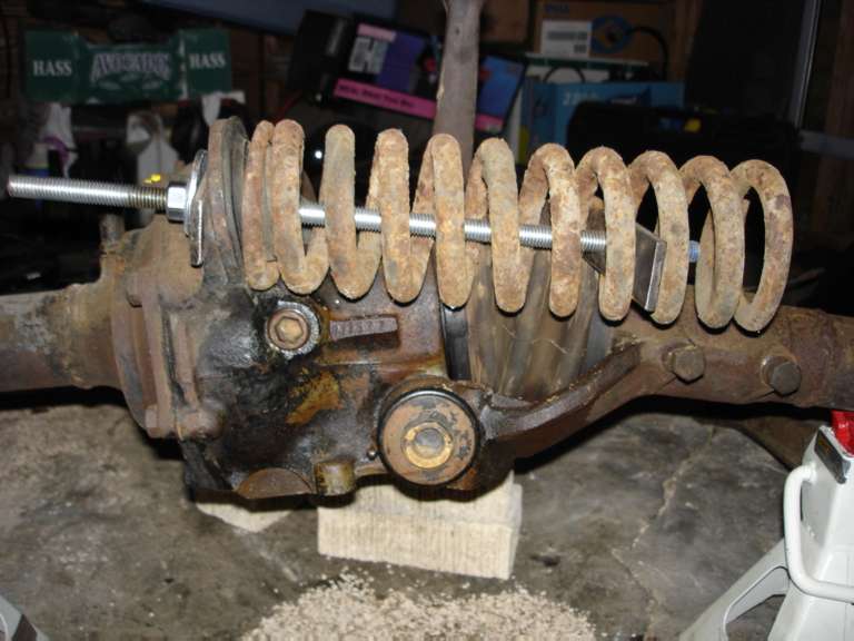

While we are on the subject of suspension. I purchased John Olson's progressive rate springs and  put new bilsteins and redid some of the back and front bushing that go bad. The bad news is I di not calulate the height correctly because the shop I was using was solt  of loosey goosee and I wanted to make sure my car keep its orginal parts. so I with out first taking out the spring pads purchased 25 mm for front took out 32.5 rear 24 mm took out 18 mm. not oly that but they used chicken wire to tie the compensator spring to put it  back in. I could of done a better job with my eyes closed.
My question is has anyone found a way tool to compress the compensator spring? I am going to have John repowder coate it and make it nice again.
mbzse

Originally posted by Bob G
.../... has anyone found a way tool to compress the compensator spring?
Bob and Forum,
I use a device similar to what you see here, when removing or mounting the compensator spring or changing end rubber rings. Compress spring, remove support on the right (two bolts), release spring tension, remove spring. Safe and convenient  8)
(Note: picture is not by me, borrowed off the web)
Download Attachment: Ausgleichsfeder Comp spring removal.jpg
50.63 KB
