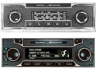

When I bought my Pagoda she came with a tape cassette player and similar speakers to yours in the back...
Cut a long story short I wanted the Becker radio back, and what with the mobile phone laws here & wanting to connect an ipod + Sat Nav etc, I opted for the Becker 7948...Ipod connector in the glove compartment, + voice recognition + phone hands free + Sat Nav all built in .
I am using the same rear speakers & also managed to use the front top speaker as well .
Quite a splash out, however I think it was worth it as I don't like a lot of clutter to spoil the lines of the interior.
You can change the colour of the Radio face to the colour of your interior!
[ Toys for boys! ] (' ;) ')
Kemal
280 SL Manual 69
