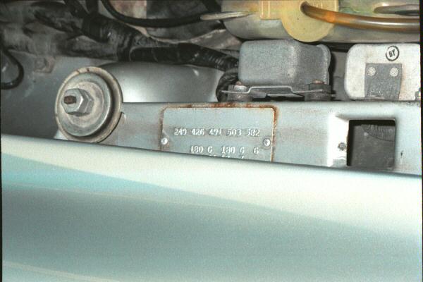

Brian, to be sure your SL is a US version, look at your plate in the hood, drivers side, where the option and colour codes are.
on the first line, if you find the code 491, then your car is a Us version for sure. (see picture of a US version plate, 491 is the middle number).
Download Attachment: my280sl plate in engine.jpg
34.62 KB
Fabrice

Fabrice, I checked the data plate in the motor bay and it reads 491, thus a US model as you suggest.
