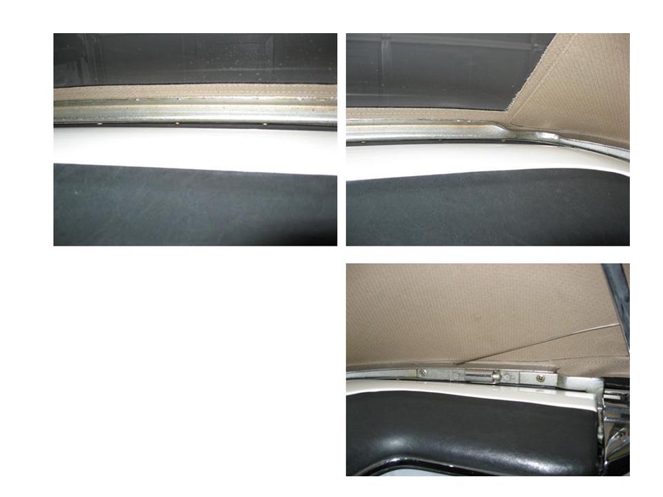

As I prepare to replace my softtop, the one thing I don't have are photos of a car that has a very well fitted soft top. I want to ensure my frame is correct before I start. I'm reasonably sure I can get the outside to fit properly and what it should look like, but what I could really use are a few photos of the interior specifically at the rear corners where the back corners of the softtop meet the softtop cover. I am particularly interested in how the bar holding the rear seal sits against the toneau cover. My car has a quite a large gap at the rear corners and I need something against which to compare it and so make sure the wiki entry is as good as it can be and that my frame is properly adjusted before I start.

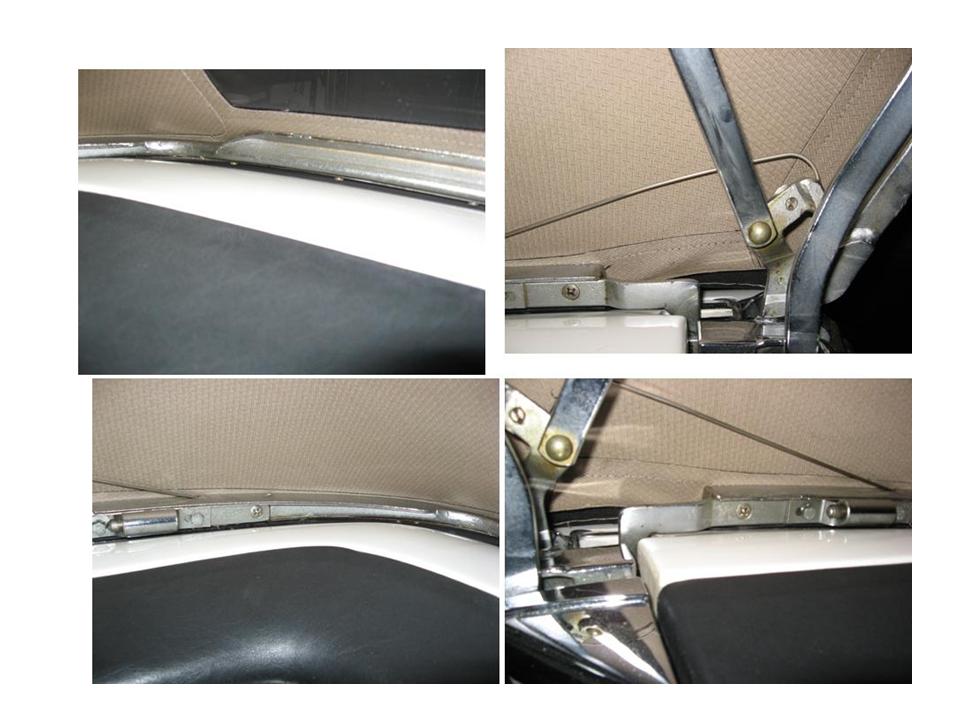

« Reply #4 on: December 10, 2007, 21:42:46 »
James;
Here're some pix of my top. It's a recently installed GAHH black with tan herringbone liner.  It was installed by a local auto upholstery shop.  I hope this is what you're looking for.  Let me know if there is some other detail you need.
Steve

What are the thin pieces of wire for shown in the first set of pictures and are they normal for a 280 ? If so, where can I get a couple? I have a GAHH top.

My thanks to John Harkin and Steve (beautiful job on that softtop by the way) for the photos. I think I'm gradually realising the scope of the challenge. Errrmmm. Too late!
I need to figure out first how to reform my frame before I set about putting a new top on. Steve's photos look like the frame is superbly well adjusted.
