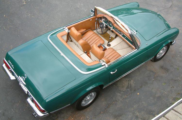

My green/cognac 1965 Euro 230SL has the original light tan rubber mats in front, essentially matching the interior color.  I use Coco mats on top of them for normal driving, and usually for shows I put in the square weave carpets that match the other carpets, as shown in the photo.  Not absolutely correct, but I like the way they look and only once did a judge remark on them.
Chris
Download Attachment: Interior.JPG
62.23 KB

Did someboday say these rubber mats were still available? Where praytell?
I would be inclined to do what Chris does -- rubber with carpet on top.

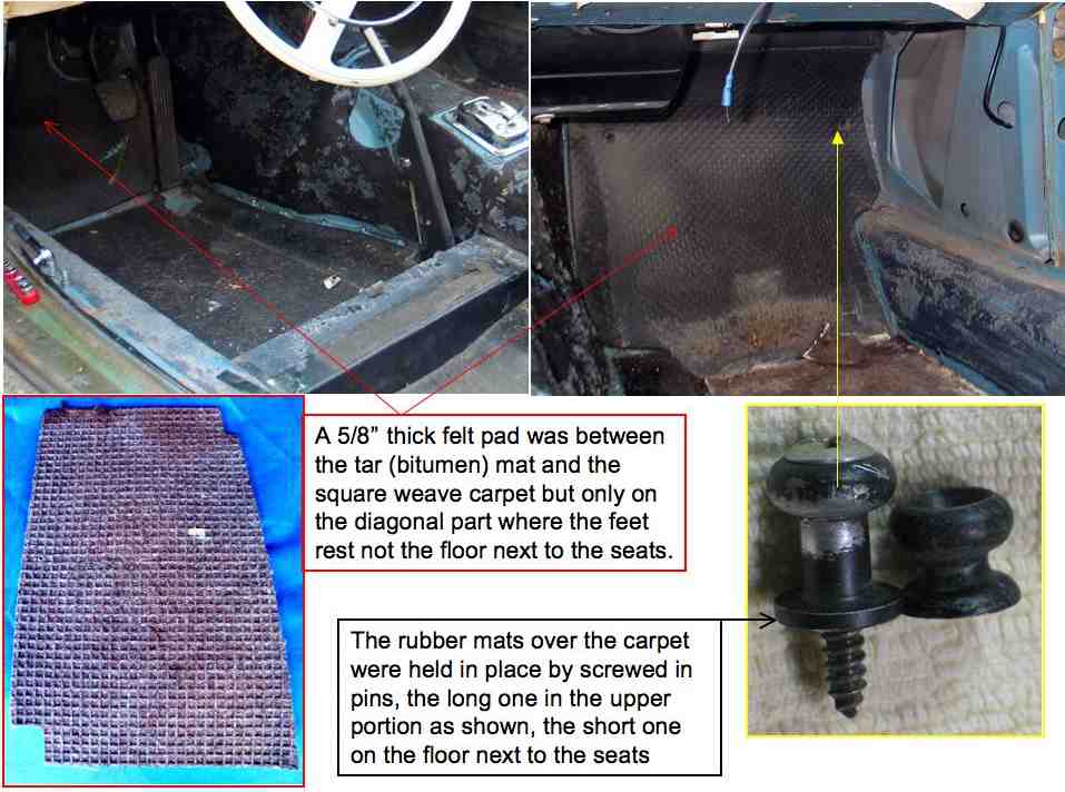

Chad,
I am pretty sure that the floor covering on my 230SL (August 1966 built)  was original when I stripped it.  First there was a 1/4" thick tar (bitumen) layer melted to the floor panel (this layer was not as thick over the tunnel and the vertical walls) and on top of it a 5/8 thick felt pad where the feet rest. The square weave carpet was glued to the side walls and the tunnel but NOT on the right side where you need access, as the Doktor described.  Over the carpet were black rubber mats held down on 4 corners by bottle shaped pins that were screwed into the floor panels.  See attached picture for details.
I have now used Dynamat-Extreme (about 4mm thick) fo replace the tar layer. It rolls on easy and doesn't come of the floor.
Download Attachment: Floor covering.jpg
68.3 KB

« Reply #12 on: December 10, 2007, 19:28:36 »
Hi Alfred. Are you saying that the rubber carpet was on top of the squareweave carpet? If so, were those pin thingamajigs poking up through the carpet (and then holding the rubber?)
One reason I ask is, with my "newer" carpet set (not with the rubber floor but carpeted one), my driver's slide slips and slides when I drive. So I went ahead and poked that pin through it. I am thinking of putting a grommet of some sort in the hole for reinforcement.
Also, I believe I replaced "original" carpet and I am pretty sure it was carpet not rubber. Maybe the rubber was there originally but vanished.

« Reply #13 on: December 10, 2007, 20:02:44 »
To me sounds like Alfred means the rubber mats were buttoned down *on top of* the square weave carpet.  To quote him.
There seems to be a small debate regarding this question brewing up. To quote his posting:
"Over the carpet were black rubber mats held down on 4 corners by bottle shaped pins that were screwed into the floor panels."
I have had some cars from the 50s and 60s before.  The ones that had rubber mats never had carpet in the same place these mats were, either above or below the rubber. But they were Italian and British cars and didn't have the comfort level of the w113 models, so having no original knowledge myself I guess that all iterations are possible.  Anyone own the car from new and can shed light on it? Achim often provides a definitive resolution to these questions, I believe?
It is a bit of trivia.  I will eventually replace the carpeted floors with rubber mats which seem to be the correct use from what everyone says.

I'm pretty sure he's saying the square weave carpet was on the door sills (running to the firewall) and the tunnel.  The rubber mat was on the floor on top of the felt (I think it was jute originally) which was on top of the tar layer.  This is how my early 250 SL is, but the rotten jute is replaced with felt.  There is no square weave carpet under my mat.
http://farm3.static.flickr.com/2122/2102525330_101d1d6df9_o.jpg
My 190 SL, the prior model to the 113, was all rubber mats on the sills, tunnel and floor.  The 113 was an "upgrade."

Hi John,
you are correct, that's what I wanted to convey.  Looking at your picture it looks just what mine looked like except you have a loop carpet and I had a square weave - as all 230SLs had.  Where was the jute/felt pad in your car, under the loop carpet? Or did you put that carpet in?
Anyway, when I ripped my carpet out - above the felt and the below the rubber mats I still could see the number that the installer wrote on it before gluing it down on the floor panel. So I do know that the square weave carpet was original.
James,
the screws, NOT the short pins, went through the carpet and the tar layer , they were pressing down onto the carpet. The longer pins had been pushed through the carpet and the thicker tar pad but I don't know whether that happened over time or was intentional.

Hi John,
Looking at your picture it looks just what mine looked like except you have a loop carpet and I had a square weave - as all 230SLs had.  Where was the jute/felt pad in your car, under the loop carpet? Or did you put that carpet in?<hr height="1" noshade id="quote"></blockquote id="quote">
Actually, the carpet you are seeing in my car is square weave, it's just that the wool threads are mixed up rather than one color per square.  What you are seeing on the tunnel is the original carpet to the car.  It has not been replaced.  The sills were replaced with identical to factory original carpet in wool.  The newer felt pads (replacing deteriorated jute) are under the rubber mats.  I can't say what's under the tunnel and the ring in the carpet around the stick is vulcanized to the boot (the way it was done from the factory).

Chris,
I wanted to comment on how nice your car looks. What a stricking color combination. I would love to see more pictures of your car. It's a real looker.
For all forum members I recommend going to the below website as a reference for great pictures that document correct 113's. Brian Peter's website.
www.motoringinvestments.com

« Reply #24 on: December 12, 2007, 16:53:44 »
Originally posted by perry113
Posted - 10 Dec 2007 :  14:51:31
Chris,
Perry,
Thanks for the compliment.  There are more photos of my car on this site in the thread http://sl113.org/forums/index.php?topic=2585 and (with some overlap) on my website at http://home.earthlink.net/~cearnest2/Mercedes/
