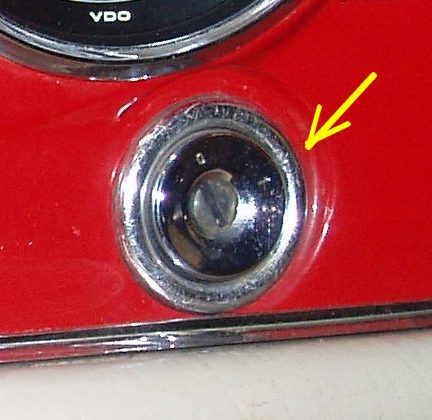

Anybody knows if these rings are available? I called K&K and they don't have them, they checked with their "supplier" in Germany, also don't have them at this point.
Download Attachment: IgnitionRing.JPG

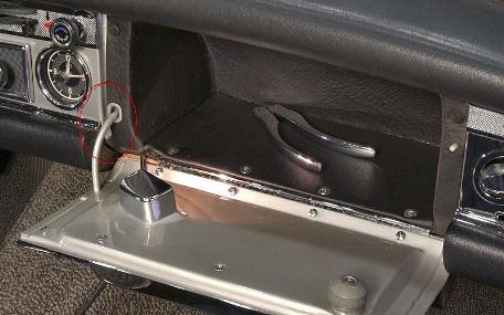

Er... not quite, Alfred.  The ring Dave and I have offered is situated at the glove compartment, (see attached photo, red marking).
Download Attachment: Glove compartm w Ring.jpg
28.19 KB
The ring Roman asks about is part No 110 689 01 80, and when I now try the database, indeed it shows up as non-availabe.

Roman,
Check with your MB dealer parts dept.  The part number you want is 115 689 00 80 (Escutcheun, steering lock opening).  I got one not long ago.  They are still stocked by MB.

fyi...
In addition to the chrome trim surround, there is also a rubber grommet used.  I found today that that part number is:
MB PN# 115 689 00 97
Per the local Memphis MB dealership, both the chrome and rubber are available via special order...
