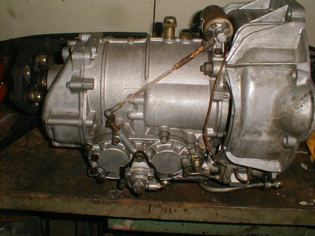

The 10mm lock nut with small slotted screw on the venturi is factory set and should not be tampered with. Often times mechanics mistakingly use this to set the idle. Changing this setting will adversly effect transmission shifting and injection mixture by changing linkage geometry. See picture. Download Attachment: P1010026.jpg
57 KB
This lock nut and screw must allow the linkage, at rest to completely close off the flap (butterfly valve) in the intake venturi. The slotted screw must be set to just barely keep the "flap" from binding in the intake venturi. (Some USA Cars have a vacuum pot which may need to be temporaraly be moved out of the way since it will also hold the "flap open".) Now the linkage can be adjusted and re-attached. Loosen the slotted screw until the linkage flap binds when closed. Now adjust the screw until the flap just closes without binding. Lock the 10mm nut. Adjust the length of the injection rod link to 233mm (center of socket to center of socket). The linkage on the injection pump should be resting on it's hard stop also. Reconnect and adjust other rods if needed. Check to see if the flap in the venturi opens completely when the accelerator pedal is held to the floor. W113 engines with automatics have  switch on the opposite side of the intake venturi and some also with a micro switch on the firewall. This will cause shifting changes if not adjusted also. With the engine at idle and in gear, the venturi switch should have power to both wires (switch on), as soon as the accelerator is moved there should be power to one side only (switch off).
The transmission modulator pressure is changed by the activation of this switch which activates the three positioned solenoid on the automatic transmission. This solenoid moves a short linkage rod on the transmission which changes transmission modulator pressure. The correct adjustment of this switch can make drastic changes in final downshift especially.
Download Attachment: P1010027.jpg
60.59 KB
The transmission modulator pressure is also influenced by engine vacuume at all shifts. The engine vacuume is influenced by engine timing, linkage, mixture, in general the health and tune of the engine. So you can see how this is all interconnected!
As far as the injection, the mixture screw on the back of the pump will change fuel mixture mainly up to 1700 rpms, then the other internal adjustments control the other ranges. Normally additional internal adjustments would not and should not be needed. The entire rpm range of fuel mixture is also influenced by the warm up unit on the pump, barometric compensator, rpms and LINKAGE. Notice we keep getting back to this variable. Any system vaacuum leaks or internal fuel leaks (cold start fuel valve into intake),  will also influence fuel mixtue in all rpm ranges. The ignition can also create many elusive problems which sometimes immitate a fuel mixture problem. If you have a couple things happening at the same time then the complexity increases. Read the spark plugs occasionally, they may give you a clue.
You could be compensating for the real problem which could be sill undetected. Make sure the linkage is right so you can move on to other possibilities. I stress, check the stop screw on the venturi linkage.
