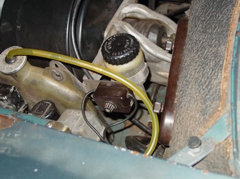

Phillipe
Look for a brown rectangular fuse box with a thumb screw in the middle on the washer resivior bracket next to the brake booster, On my car there is a fuse in there for the fog lamps, check the terminals and the wire connections for corrosion.
Al Lieffring
66 230Sl

Btw, I don't remember the little brown fuse box near the windscreen washer tank...Are you sure it's not a 230sl specificity?
