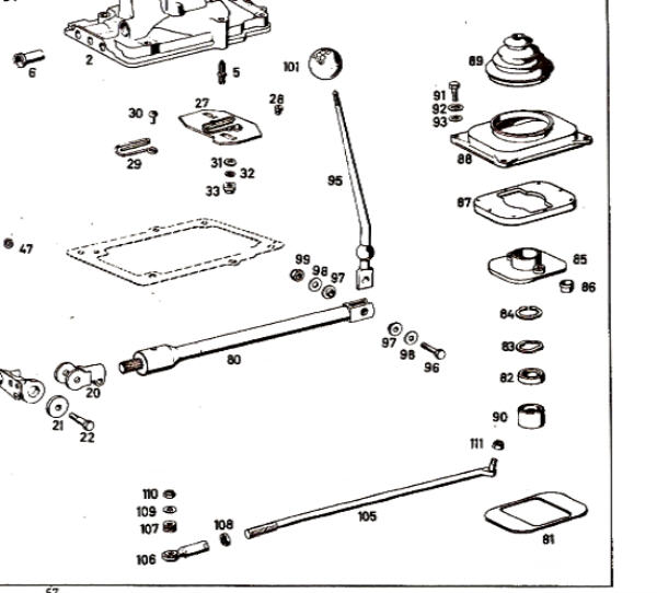

Here is a scan of the shifter.  You need to replace the shifter bushings.  Everyone has to do this sooner or later. Do a search on this site for "shifter bushings" and you will find all the info you need.
Download Attachment: shift bushing.jpg
44.2 KB

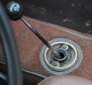

Mine dropped shortly after purchase two years ago.   Exactly the same as you, I could lift and shift.  Mine was disintegrated shifter bushings.
Download Attachment: IMG_2725.jpg
28.86 KB
bjudd
