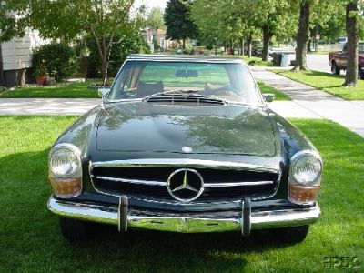

My first question, however, stems from personal confusion over all the many pics I've seen of headlights and tail lights. I've seen both the solid red as well as the red/orange TL's on nearly all year 280's... I assume this has to do with replacement availabiluty??? What was standard US dress for a 68 280SL?
Similarly with the HL's, I've seen the lower signal portion with the darker orange "lens" as well a lighter almost clear "lens" regardless of year... and I dont mean the Euro HL's. What was standard for the 68 280?

Thank you, Cees, for the thurough reply.
My solid red TL's are therefore appropriate. The P.O. must have replaced the original AN's appropriate to my 6048 chassie number with the lesser expensive AJ's.
I, too, prefer the red/amber combo, and will one day add them... along with a pair of the beautiful Euro headlights. :D
