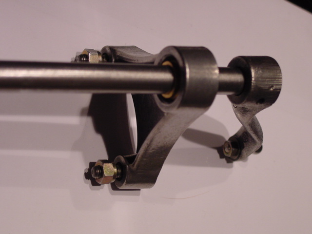

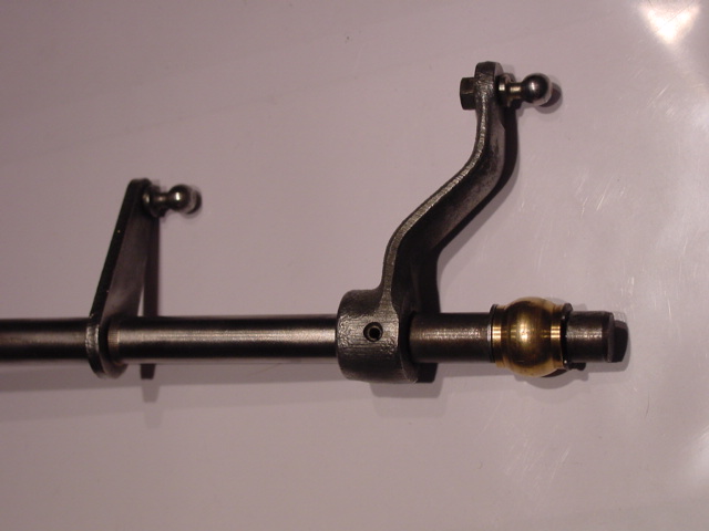

Hey Gerhard, what a coincindence. I just did this today! Let me take some photos now that the set-up is at home.
I replaced the 'easy' brass bearing already last year with a new one. This is the one on the side with the two, rather than just one, 'arm' to which linkage rods are connected:
Download Attachment: DSC00536.JPG
61.03 KB

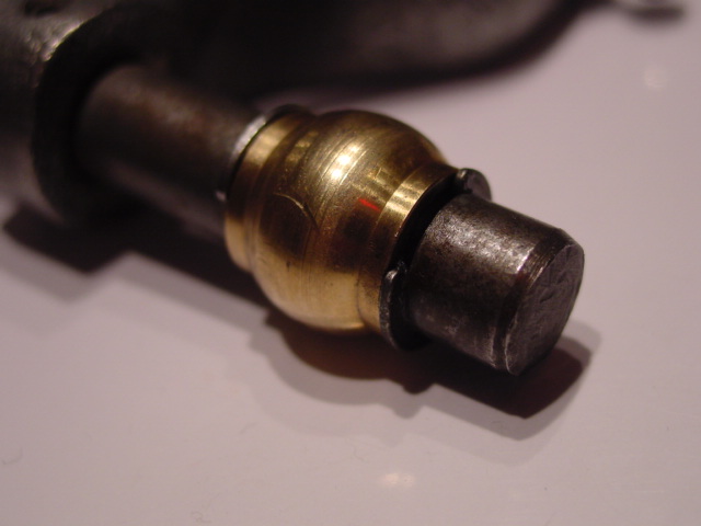

On my car at least (and I suspect it's the same on all Pagoda's), it is held in place by two circlips that can just be pried off:
Download Attachment: DSC00535.JPG
58.09 KB
Now the other side - PLEASE NOTE: I PUT THE BEARING HOLDER ON BACKWARDS, IT IS SUPPOSED TO BE ORIENTED IN THE OTHER DIRECTION:

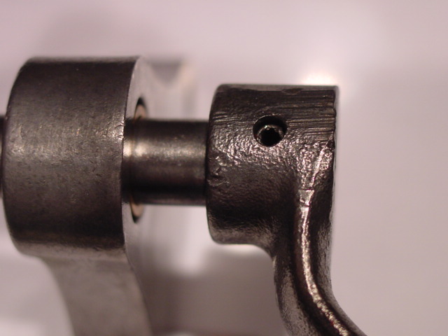

This is a bit more difficult. The arm at the end of the rod has to come off. To accomplish this, just drive out the steel pin with a suitable 'driver' (I used a small-size bolt) and a hammer:
Download Attachment: DSC00538.JPG
59.59 KB

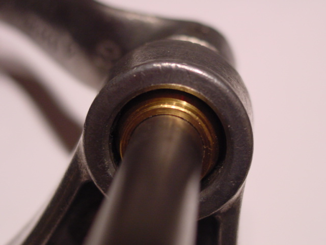

Then you can remove the support with the bearing in it. The brass bearings are kept in place with a steel ring that is snapped into the housing. I spent some time with very small screwdrivers, in order to get this ring out so I could remove the bearing. Unsuccesfully so, it's far too difficult. Then it occurred to me: the steel retainer ring can stay in place, the bearing can be forced past it by applying pressure from the other side. The ring widens to let the bearing through. I put in a bit of oil first, to make it all easier. Here's the side that the bearing needs to come out, and where the steel retainer ring is (not visible in the photo):
Download Attachment: DSC00539.JPG
58.92 KB
The way I applied pressure was putting the whole thing in a vise, with a small socket the size of the bearing diameter on the narrow side, and a larger socket, just a bit larger than the bearing diameter on the wider side. It came out very easily.
When I put the new bearings on the rod, I put some very thick grease on first, to lubricate but also to almost eliminate the very last bit of play that exists even with new bearings.
Hope this is clear,
