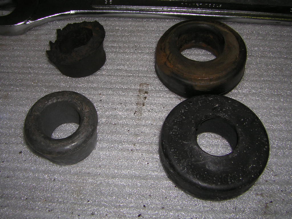

Here's a photo of some of the old bushes alongside the new ones. Without doubt the hardest job, as I put in another post, was getting the large 32mm nuts off the rear of the trailing arms. But that's another story.
