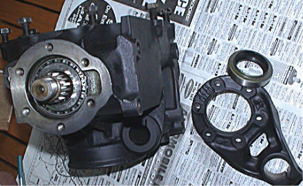

Re: rear pinion bearing replacement??
« Reply #3 on: August 02, 2007, 15:12:21 »
Here is a pic of the bearing.
Download Attachment: pinion bearing.jpg
« Reply #4 on: August 02, 2007, 17:49:50 »
great pic . do i need a special puller for this job?
