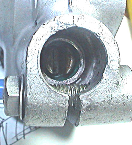

Re: speedometer cable problem
« Reply #3 on: October 26, 2007, 10:44:41 »
My manual tranny speedo cable (original?) has a rubber seal.  It compresses in the housing against an oil seal for the driven gear shaft.  It keeps road dirt, moisture, etc from attacking the inside of the speedo cable.  Here is a pic of the manual trans speedo cable connection.  The picture is upside down from the final installation.
Download Attachment: speedo cable.jpg
50.81 KB
When installed the cable is inserted from underneath the housing at a 45 degree angle.  The driven gear shaft connection is about 1 inch deep inside the housing. The rubber ring on the cable is about 1/4 - 3/8 inch in height and it seals the opening in the area beneath the bolt in the pic.  Without it a gap about 1/8 inch wide by 1/4 inch or so is open and exposed to the elements.  This gap can be easily filled by a short pice of rubber 5/8 dia hose.
