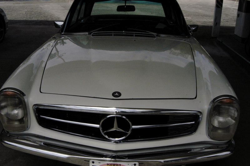

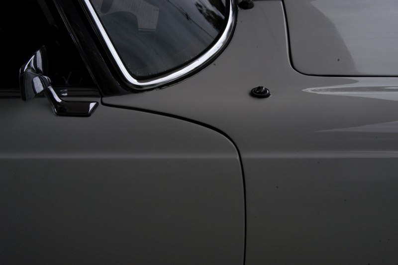

I guess what bothers me most about this car is the re-paint. As you can see from the pictures, the gaps appear to be o.k. -except for the hood -where the gap in front seems too large. It could be it was not aligned properly after the painting? I could find no signs of rust anywhere except two places: a tiny bit around the wiper blade and a tiny bit in the rear at the seam edge beneath of the bumper. (pics attached)

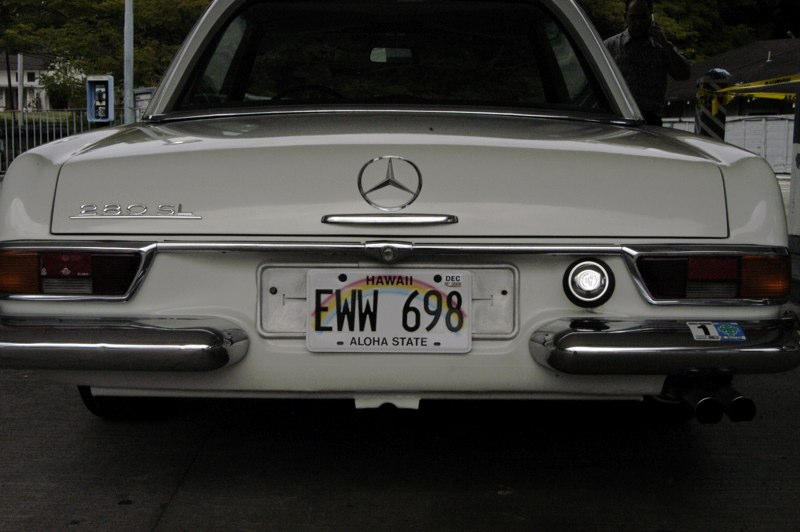

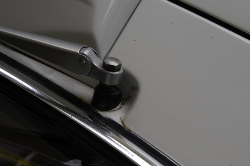

That rust on the bottom of the tail panel concerns me. If the car was painted fairly recently, this would imply to me that the paint job was done to hide -- rather than eliminate -- rust.
I'd certainly examine the inner fenders by opening the hood and running my hand (carefully) along the lip of the inner perimeter of the engine bay. My guess is it's rusty in there as well.
Also, did you lift up the trunk mat? These are all classic areas to examine.
Finally, I'd purchase a magnet that measures metal thickness to look for filler. I've got one that's called a "Spot Rot" detector and find it invaluable when looking at old cars. (I bought it on ebay a few years ago, but I think JC Whitney sells something similar.)
On a more positive note about this particular vehicle, i was interested to see the tail panel up close. Clearly, it has a reinforced panel for a boat hitch. There's a piece of metal welded between the outer skin and the fuel tank. I've never seen that. I wonder whether that's a factory job and what option code is indicated, if any, on its data card?

I concur with Douglas-- you can do better with $24k. The link he sent is a great resource. Look for the 'notches' around the headlights, and the spot-welds along the inner front fender edges. (see link for more details)
One area that concerns me in particular is the rear lower panel: it looks very uneven, and I'll bet is full of bondo. That reinforcement may have been an attempt at a hitch, but also to possibly shore up a crumbling lower rear panel. I would place it on a lift and inspect underneath the entire car.
Also, the hood gaps look wrong, but this could just be a bad placement after removal for engine work.
The $11k bill might have been someone trying to rip off an 80yr old lady. That paint job leaves much to be desired at such a price. It could also have been in an accident (rear-ended?). Get more details from the shop where the work was done.

That lower rear (non-structural) panel is notorious for rusting - I am getting mine replaced sometime in the coming week or two with a $200 repair panel and she'll be as good as new again. After double-checking for rust as well as the more serious mechanicals (engine compression, leak-down test, brakes, suspension and steering parts wear, etc), you can just bid what you feel the car is worth: maybe you will want to get it repainted, which should not cost another $10K, replace the rims (just as an example, correct MB, profesionally repainted bundt cake alloy sets are available for a couple hundred dollars here in Germany all the time) and the steering wheel, and do the rest (carpet, interior?) as you go along, over the coming years.
Who knows the seller may take $15K and you could end up with many years of sunshine fun!

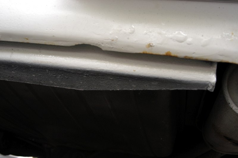

You should remove the outer rocker panels. This may be some work, however it is worth it in order to estimate the real value of the car. If you find serious rust here you should not buy the car for this price.
In addition: You may want to poke around under the car with a screwdriver to see if it is solid.

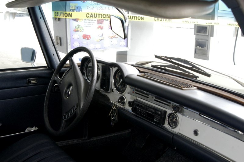

The steering wheel is from a 1970's MB sedan.
The heater/vent controls are missing.
Radio antenna missing?
Aftermarket non-locking gas cap.
Show more pictures and I'm sure more people will find flaws.  We know shortcuts when we see them!

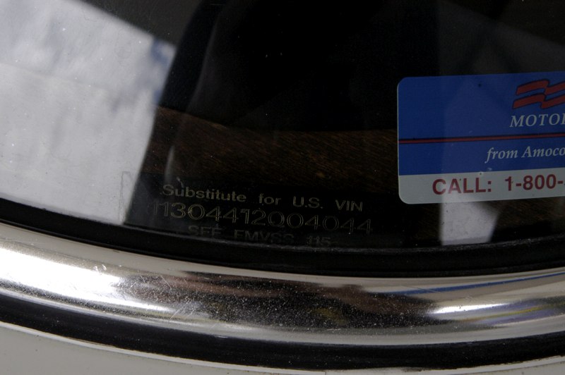

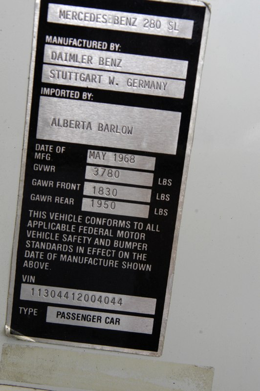

What's with the "replacement for US VIN" plate under the windshield.  I've not seen one of those before.

the car was a non-US version and was imported to the US under gray-market rules. These mandate that the importer brings the car into compliance with US regulations (FMVSS - Federal Motor Vehicle Safety Syandards, and EPA or CARB - California Air Resources Board). The Type Plate shows that such an effort was made. The FMVSS 115 was only introduced in 1980 and showing the VIN under the windshield is not required on a W113, so the importer did go overboard in this case.
