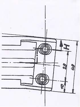

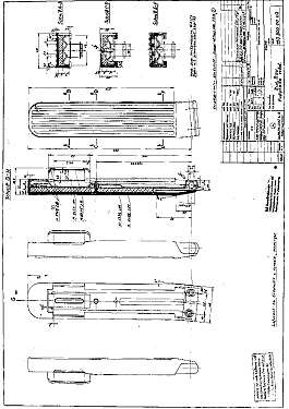

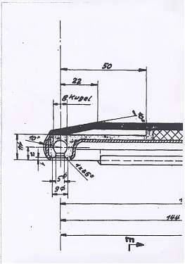

« Reply #14 on: January 26, 2007, 12:58:21 »
Hope this can help you to solve your problem. Don't recall where i got it from
Download Attachment: MBT Gaspedal 01.jpg
22.47 KB
Download Attachment: MBT Gaspedal 02.jpg
12.86 KB
Download Attachment: MBT Gaspedal 03.jpg
13.89 KB
