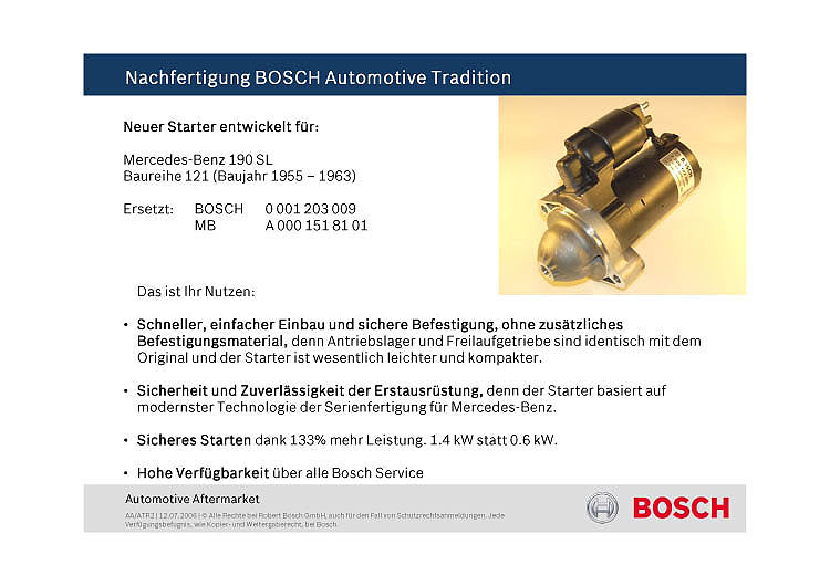

Jim, I don't know too much about 190SL's but as soon as I get that article in digital form I'll post it.  You can go to the link I posted here and you can see that this is a new product, an improvement over the original, and one made in cooperation with the Classic Center (who placed the initial order) and the INTERNATIONAL 190SL group.  I'm surprised you haven't heard about it; my guess is the International Group didn't tell the US group!
Based on what JA17 said, it looks like they nailed the problems with the original.
Here it is:
Download Attachment: Bosch copy.jpg
83.25 KB
It's nice to know Bosch has set up a group to work on parts for old cars...

Michael .... If the International 190SL Group was involved, I would know about it.  I am on the Board, I am the webmaster and I run the Club Store.
The starter that was no longer supported had rubber bushings between the bolt and the starter.  The bolt was special in that it was 12mm to go through the bell housing and 10mm to go through the bushing part of the starter.  It may have been a good idea at the time but it did not stand the test of time.  I believe that the replacement starter that fits most ponton cars is a significant improvement.
I would be very interested in the article.  You can email it to me at  Jim Villers

I don't know German, so I can't say what's in the article (page) that Cees posted.  Here's the link just in front of the German article:
http://www.automotive-tradition.de/en/teile/aktuelle_nachfertigung.htm
