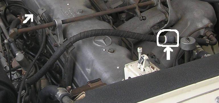

  While detailing my engine and trying to change some of the old tubes and wires I thought about changing the cotton covered tube that goes into the brake system. Before doing that I checked various other engine pictures and found that all have this small connector (please see picture). Is this connection necessary - what does it do? Or I could just have the tube running from the manifold to the brake system.
Also in the attached picture I have put a small arrow towards a wire that goes into the engine I wanted to know what it does and how can I pull it off then change its position to tigh it well.

The 'small connector' is a check valve (one-way valve) used to maintain the vacuum in the brake booster, so yes it is necessary.
The 'wire' is the tacho cable and needs to remain straight with no kinks in it.
That doesn't mean you can't secure it as shown in the picture, but it must remain straight or your tacho won't work properly.

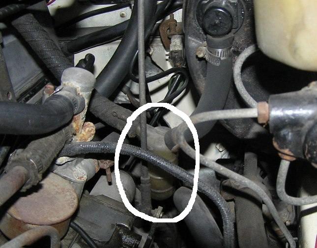

  I have attached also another picture for the other side of
the brake tube and you see a small container holding both ends.
This seemed strange to me - could it be to compensate for pressure
or does it have another utility?
Also, what does tacho mean and where does the wire
end on both sides, and how can you take it off from the
engine side.

The plastic piece in photo #2 is a catch basin to prevent any brake fluid that might leak from the brake master cylinder into the vacuuim booster from getting into the intake manifold.
The tachometer is a mechanical gage and is driven by a rotating cable (inside the black tube) that goes from the front left corner of the engine block through the fire wall to the back of the tachometer. There is a threaded collar that twists off where it attaches to the drive fitting on the engine block.

  Al is the container in the second picture necessary?
I looked at so many other engine pictures non - had it -
which means I can do without it and connect directly to
the master brake cylinder.
  As for rust I bought the car from NC, USA a few months ago.
This is the only spot - Warm up device - where some rust shows.

Abbas,
I checked the MB parts catalogue and the little moisture trap was not installed on the RHD cars like mine.
So I figure you will be able to remove it if you want to.

I have never seen any trapped fluid in these pieces on the cars I serviced, even on cars that had a leaking master cylinder. It is just another of those redundant systems MBZ likes to install on a car.
You would not gain anything by leaving it off, and it would not be any more dificult to reinstall it in the new hose than to remove it, so I would say leave it in.
Al

I am curious. Looking at engine bay pictures I have seen this plastic bulb only on M127 (230SL) but not on 280SL engines. Is this correct?  Is the trap function perhaps built in somewhere else in the later models?

I realy don't rember at what point in the production the trap was removed from the booster hose.
But a 69 280sl does sound like it would be in the "after" category.
So I change my mind: leave it out.

Al and Alfred,
Do your 230s have this trap?
I think it was a very early 230s thing.
My '65 230 (chassis 009084) did not have one but still had the original vacuum hose with the correct band type hose clips.
I believe Mr. Huber's early 230 (chassis # ????) has one.

OK, one more voice: my early '67 250 (1519) has that little plastic trap, complete with original hoses still secured by the factory band-and-key hose clamps. Its function is not known to me.
(268)Green 250 Coupe

Let me clarify that this is for my second 280 year 1968 chassis
# 113 044 12 002098 which makes it an early 280. My other 1969
#113 044 12 008005 does not have this trap.
Sorry Al for the confusion  :)

Hi. Naj is correct on mine -- #871 has the trap. I recall someone once saying it was a "condensation" recepticle or the like.

My car has one, built Sept. 1966.  If it's function is to collect condensation, perhaps nobody sees anything because it's seldom a problem, or evaporates again later.

Yes Naj,
my 230SL (built Aug. 1966) has the plastic bulb with original clamps. But now I am very much tempted to leave it off when everything gets reconnected again. Frankly, it looks somewhat crummy.
