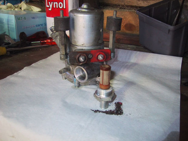

joelj,
The fuel pump in your car might be the new small type pump that was fitted to the 280sl model.
I see that KevinC has a 230sl.
Compare this pic to your pump then you will know what model you are asking about.
It shows the new small pump. note that it has the exiting pipe going up at about 60 degrees.
Download Attachment: FuelPumpFilter.jpg
68.45 KB
Either way, both the old style and new style pumps can be rebuilt for a fraction of the cost of a new pump.
For the later pump like the one shown, MB sells a kit containing seals and brushes for the motor.
Kit Part number A000 586 01 47  from 280sl model number 15765
