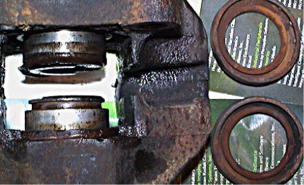

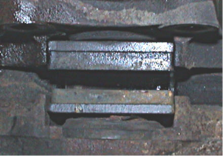

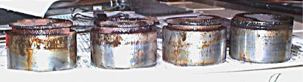

As I replace the axle on my 280SL I've been going through all of the rear end components and making repairs as needed.  I've posted some pictures of calipers which came with the two donor axles I bought and assumed their poor condition was due to sitting around ourside and not being in service. That assumption was not correct.  Here are some pice of various rear brake compnents on my car which I thought were in okay shape.  I was very wrong.  The first picture shows a stuck caliper.  You can see from comparing the pad thicknesses from each side that one side was stuck.

The next picture shows a good view of the uneven pad wear.
Download Attachment: uneven wear.jpg

The rest of the pitures are of dirty pistons and rust clogged seals.
Download Attachment: piston seals.jpg
40.71 KB
Download Attachment: pistons.jpg
19.18 KB
What I thought was a pretty solid rear braking system turned out not to be.  I was very surprised and suggest we all take a look at our brakes in detail and change the brake fluid regularly.

The old pistons were like those in your pics.
I don't know how they could be resurected but I am sure someone could re-use them.

One thing I see about the pistons in the last photo - the corrosion seems to be "outside" the seal, between the seal and the dust covers.  Annual flushing won't do anything for that.  I had the same problem on one of my rear calipers last year and they have been flushed at least annually.

I think you're right.  Very good observation! I did have some rust inside the caliper piston socket but most of the problem was outside of the piston seal and between the dust seal.  Maybe the dust seal is a real culprit here and we should consider replacing it periodically.  I did install new dust seals as part of the caliper rebuild and found them very hard to install until I read about a tool MB describes in the BBB.  I made a version of it and the seals were much easier to put in place.
