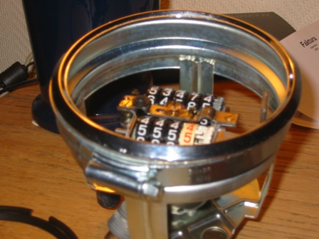

Tips: when remowing the chromring -try to "crimp" the case with a hose fastner (or whatever you call it in english - se picture) - that will ease the process...
Kjell Dreyer
Norway
SL280
Download Attachment: chromrem.jpg
