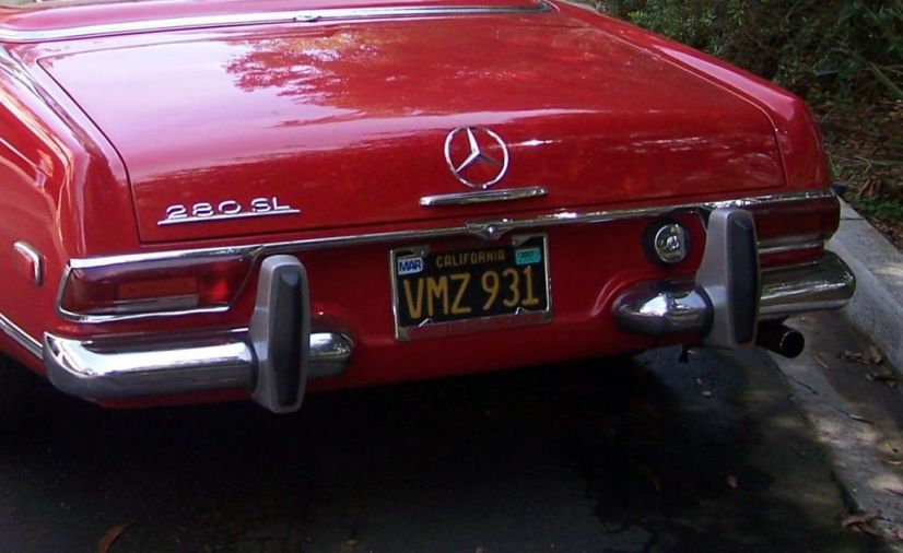

My '68 280 SL has some ugly, non-standard rear bumper guards.  I've searched this site, checked all the suppliers I know of, tried eBay several times and these guards are expensive. Best I've found is $175 each for a reproduction.  Does any one have any bumber guards for sale or know of a supplier with a reasonable cost? (No, I don't want to remove them and rechrome the bumpers.) Thanks.

Just out of curiosity, do you have a pic of your non-standard guards?  There were a correct, but very different type for the earliest cars.
Here are Rod Hersberger's rear bumper guards, he sent me the photo.  Who can tell us for what MB cars and for what years these are correct?
Download Attachment: bumpers-zoom.jpg
73.32 KB

I'm not a fan of bumper guards but I guess compared to those the correct 113 bumper guards look really nice.
They look like they're made for bigger sedans probably the 108/109 or maybe even the 600s.

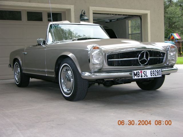

Vincesy, my car is a Euro spec car originally sold in Germany and it does not have bumper guards.  The larger guards were of the early type found on most 230sl's.
http://www.sl113.org/forums/uploaded/cees%20klumper/20047515937_DSCN0121.jpg

Houser... a little off the topic of this thread, but nice pic, & really nice car... but where did you get that nice little pseudo German front license plate with the octagonal orange date &  brown / black round registration (TUV) stickers?
Also, a couple of other things... is it the pic angle or are your hubcaps all chrome (not painted body color around the star)?
The other thing is that the car appears to be a silver/tan like DB702.. a later than W113 color.  I ask because the color looks a lot like mine (US version '67 250SL), maybe a little bit of a shade darker... but that could be the photo rendition.
