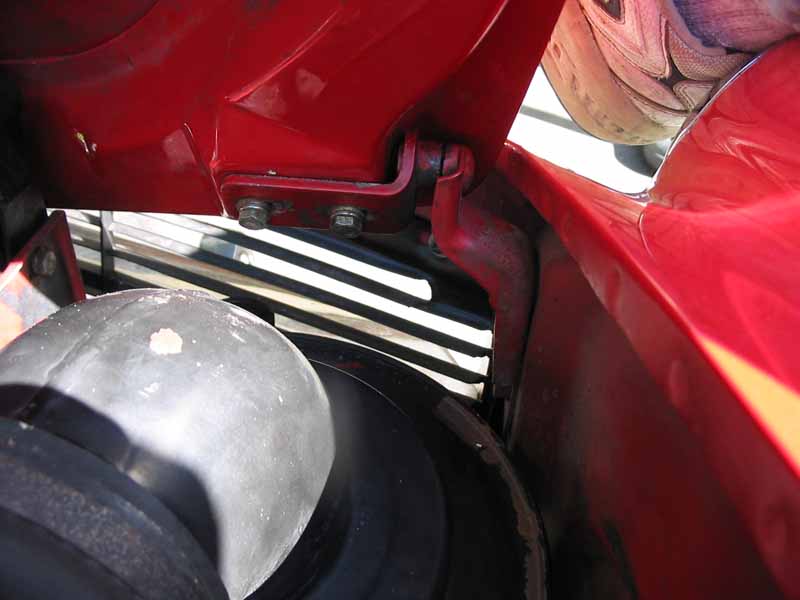

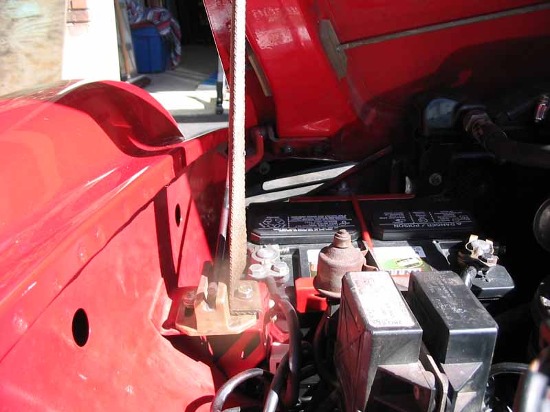

2) Draw marks with a Sharpie (permanent) marker, or use something like paint or even "white-out" to indicate the *EXACT* position of the hinges to the hood. Do NOT use chalk - it wipes away too easily.
Download Attachment: IMG_0239.jpg
52.47 KB
Download Attachment: IMG_0240.jpg
41.77 KB

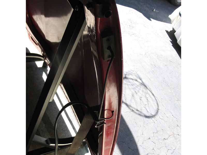

5) Have an assistant hold the hood up, from the passenger side (US models).  Grab the torsion spring, and pull it up towards the hood. Using an S-hook, secure the torsion spring (under severe pressure) to the small hole in the hood. Ernie Burchall tipped me off to use the hook from a rubber bungie cord. This worked perfectly. Here's a picture of the hood, off the car, with the bungie cord's S-hook holding the torsion spring.
