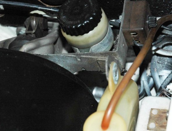

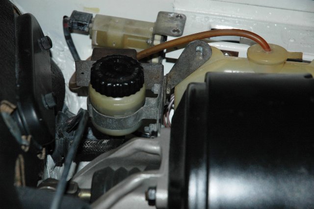

Does anyone know of a source for the bracket that hangs the windshield washer reservoir?  We're looking for the bracket that attaches to the back of the brake power unit and, on manual transmissions, also holds the clutch fluid reservoir.  My friend has a '71 automatic and there is no bracket at all.  We've tried the dealer, Calibre, Millers, etc. etc. Still no joy.
Here are a couple of photos of the hanger in my '68.
Download Attachment: Bottle Bracket.JPG
71.74 KB
Download Attachment: Bottle Bracket 2.JPG
78.45 KB

on all 280sl i have had and presently 2 there is no bracket for water bottle as on older mercedes cars. item is not listed in my 113 parts manual.
aeneas

The later 280 SLs didn't come with that bracket originally. Not sure exactly when it was discontinued.

I "believe" it comes together with the clutch fluid reservoir but I am not sure.
I will chekc tonight in my spare parts literature.

The part number is 113 290 00 86. Can be found in the figure for group 29 (pedals).  Price was Euro 16.12 in 2004 in Germany.
Might be a little more expensive now.[:0]
Good luck!
